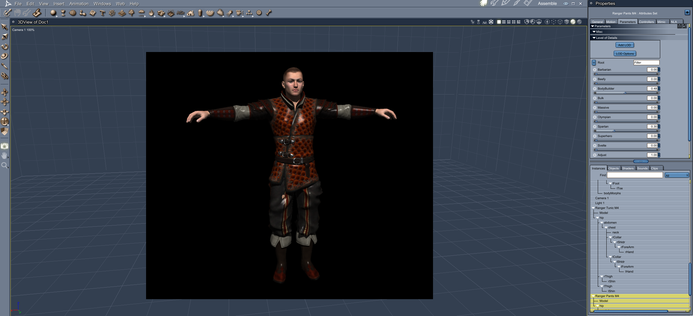

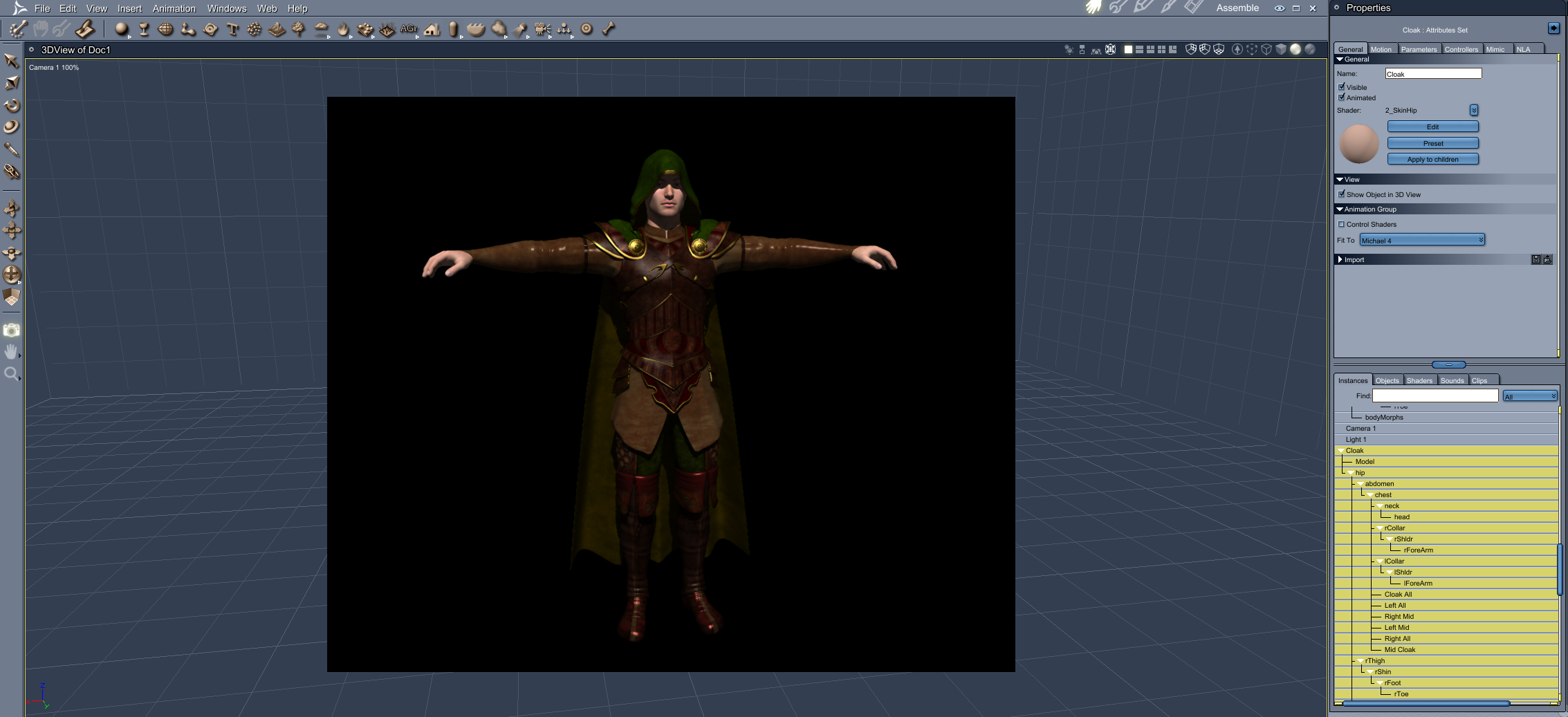

    X3D Fantasy Ranger M4
    Wildenlander M4
    2263 x 1033 - 426K
    2267 x 1037 - 410K
