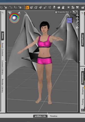

Hi I am needing help I recently got Popobawa for Genesis http://www.daz3d.com/popobawa-for-genesis and was looking at using the wings from the set on Genesis 2 but alas while they fit on with autofit as soon as I pose G2F the wings scrunch up and pretty much useless as when I move G2F's arms the wings will follow as the pic below shows..
I know there must be a way just not sure how to do so in Studio any help please would be greatly appreciated, thank you. :)

    AutoFit isn't going to be kind to an item with its own rig - you would probably be better off just lining the wings up, without AutoFitting them, and then parenting them to the chest of G2F.

    Ahh cool thank you for the help I was hoping to try a fudge Autofit and at first I tried parenting to the figure but it didn't work I think it must have been due to parenting to the wrong part of G2F.. I tried again as you said and now it is playing ball thank you for the help. :)
