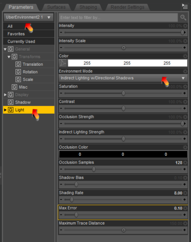

I'm still wondering how Adam succeeded to create the impression, that the diffuse ambient light (UE2 in IDL mode) throws a diffuse shadow as shown in this post.
Somewhere in the whole thread he stated that he used some kind of map for the UE2 light. Think this is to be inserted in the control marked with the red arrow.
But how in detail does it work?
What kind of picture has to be chosen for example to produce an ambient light and the very faint shadow corresponding to a very diffuse sun shielded by a high thin layer of clouds?
Andy

    With the Uber Environment Sphere seleted, in Parameters in the Light section you change to the Light Type (Environment Mode) you want with the Drop down menu. Here I have set mine to the Same setting that you asked about.
    Edit: I noticed you did that. Here is the Trick for Adams image, the UE lighting was the only lighting used in the render.
    502 x 637 - 45K

    I know very well how to change the type of ambient. What I wanted to know is what you can read in my first post. In the marked control you can apply an environment map. And I think this is what Adam stated in one of his posts. But how does this work in detail? What has the map to look like to get the effect I described in my first post? And what kind of map used Adam for his picture to produce this 45° shadow produced by the UE2-IDL?
