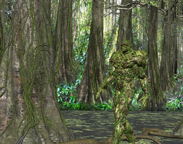

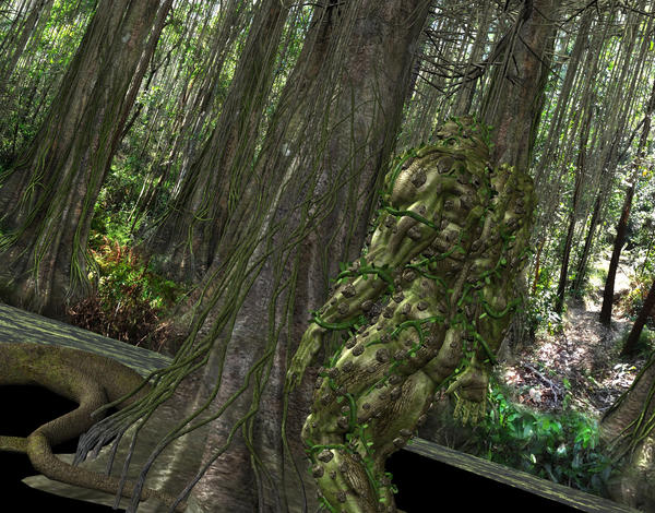

I'm in the middle of a large animation and there a huge black area appearing. What is causing this?
I just made a primitive plane in DAZ it's got 2 default distant light. at the start the plane renders fine but then you go
further along it start to disappear for not reason at all, there's an error poping up
3Delight message #13 (Severity 1): R2054: primitive (or parts of) ‘’ discarded during eye-split
Only thing I can think of is the there is a limit from the center that objects start cutting out but if that was the case the other one would two.
This really annoying as I'm trying to get some promo video done.

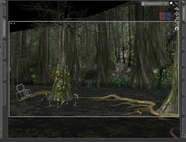

    The clipping plane sounds like the problem, but where do the change the clipping plane settings?
    1008 x 770 - 351K
  • Richard HaseltineRichard Haseltine Posts: 111,984
    As far as I am aware that's not a user setting in DS. I think this post http://www.daz3d.com/forums/viewreply/417869/ is suggesting that high shadow softness may be a contributory factor.
  • Midnight_storiesMidnight_stories Posts: 4,112
    Thanks Richard I found what it, it was the plane object it's was at a scale way too big for the clipping plane so all I have to do was scale it down to a reasonable size and the clipped area went away.
