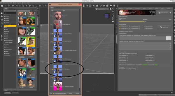

  • jerhamjerham Posts: 155
    Maybe a stupid question, but i presume you do own and installed the morph ++ pack also?
    You should have installed the following files (DIM, all to the same content folder):
    Victoria 4.2 Base
    Victoria 4.2 Powerloader
    Victoria 4.2 Base Studio CF
    Victoria 4.2 Morphs ++
    Victoria 4.2 Morphs ++ Powerloader
    Victoria 4.2 Morphs ++ Studio CF
    When loading Victoria 4.2 the powerloader screen should pop-up, which shows all the morph packs that can be loaded (sees creen shot). If not make sure as mentioned above that you have the correct libraries are added in DAZ Studio (maybe you can try reinstalling from DIM),
    1900 x 1048 - 407K
    edited April 2014
    Ok, i think i know what the problem is, you have Aiko 5 which is for Genesis and not for Victoria 4.
    You need the Aiko 4 base model, that one contains the correct morphs you need for this figure (and will also show in the list, see my previous screenshot, third from above)
    Post edited by jerham on

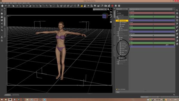

    Verinince said:
    btw, You can skip this step, when the morph packages are selected in the morph loader, they will all be loaded. You can check this/see this in the parameter tab.
    1920 x 1080 - 365K
    Based on the last screenshot, is that Aiko 4/Victoria 4? Because i'have the impression thats Genesis/ aiko 5 with a V4 pose applied?
    The "blinking" windows is ok and should have initialized the morphs for V4 (sorry missed that one in the printscreen ;-) ).
    Please do the following.
    - Load Victoria 4 from the smart content or content library.
    - Check the Morph loader import pop-up screen, if all morph packages are visible and selected
    - V4.2 : Aiko 4 Morphs
    - V4.2 : Morphs++
    - V4.2 : Base Morphs
    - Load the Susi character morph from its poses folder
