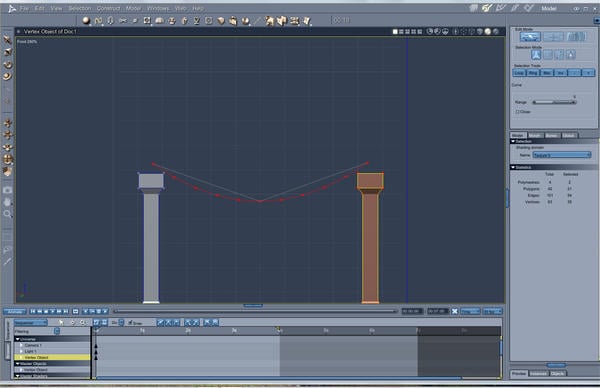

    You can also make the bend really easily by using an Interpolated curve, in the Vertex Modeller,. (pic)
    this is three clicks (see grey line)
    once you make the Interpolated curve,. it can be adjusted by moving any part of it,. it remains flexible and interpolates the curve as you move it.
    Hope it helps :)
    1566 x 1012 - 220K

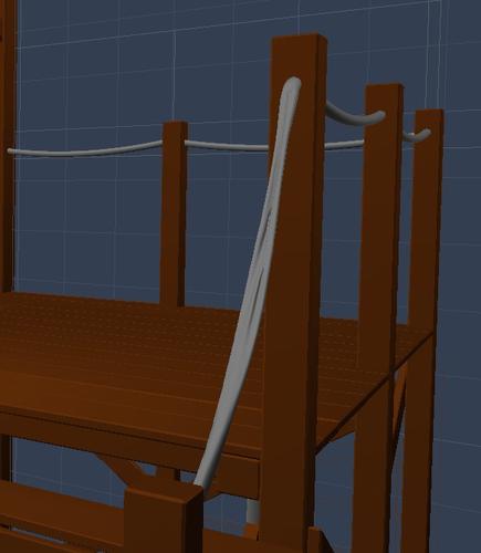

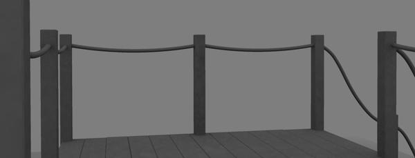

    I've had a first pass crack at the handrail rope. This is a small stage prop, although I suppose it could be a jetty or something along those lines. I made 2 rope sections, using Andy/3DAge's interpolated curve technique - one for the flat sections, and one for the steps. I used inch and a half diameter rope (which is 38 mm in new money, although my brain hasn't really caught up with modern measurements!). The bend is slightly more complex on the angled section, since the rope has to exit the post perpendicular, and I didn't want it to be too floppy.
    The two sections were, naturally, replicated to each post position as appropriate.
    I'll probably make a brass rope-end fitting for the last post, rather than trying to model a knot (although it would be an interesting exercise...)
    I'm going to try using a displacement map for the twist. I don't know how it'll come out - suck it and see, I suppose. If it looks naff, I'll have to think about modelling it. But that's for another day :)
    1541 x 587 - 58K

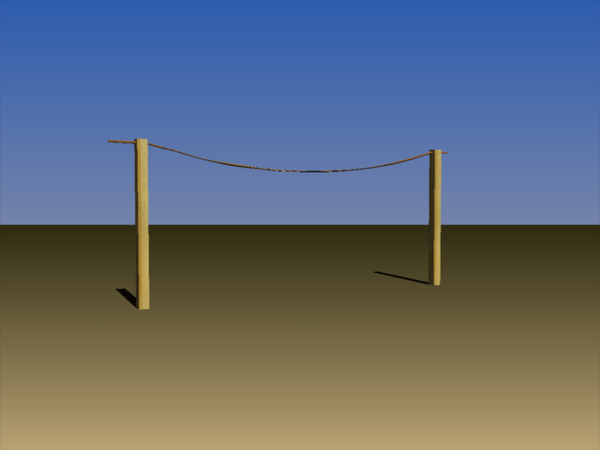

    Tried using physics on a long cylinder with many sections - gravity -50m. Exported as .obj at position end of sim, with morphs and skinning and brought it back - worked rather well :)
    640 x 480 - 900K
    That looks good - I shall give it a try later. Did you attach the rope to the posts at both ends?
  • RoygeeRoygee Posts: 2,247
    Yes...gave it two attach modifiers :)

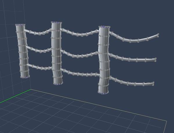

    This was done using a variation of what 3DAGE suggested. Since it is supposed to be wire, I didn't want a smooth sag, but I did want it to be relatively easy to create separate pieces that could be assembled across an uneven landscape. It is for the challenge so ignore the rest of the elements that need retexturing, etc.
    1040 x 718 - 91K
    618 x 471 - 35K
    Cool. If you have the time, it would be good to put that is the thread as a WIP image. My guess is that the whole section is filled in along the path in the VM?
