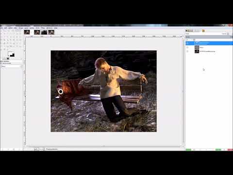

  • I got very good results scaling images down to get rid of fireflies just using The Gimp, and the Cubic algorithm. Those one-pixel fireflies like @Oso3D mentioned are particularly well dealt with.
