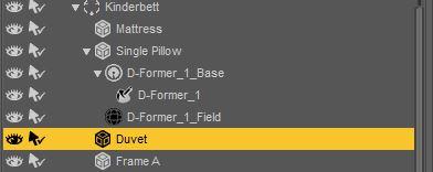

Hi,
I wanna dforce my bed and it have standard no weightmap, so... why does it act like it HAVE a weightmap? there is absolute nothing around it.
The top of the Duvet is complete static :/
I just used the duvet how it was and yeah no idea :/
I used dforce much times already and thats why I also know the weightmaps, but... there is no weightmap.

  • felisfelis Posts: 6,504
    Product can have a weigth map even though it isn't listed in the scene tab - somehow it can be set hidden.
    But if you add a weight map, it will show the weights that are applied and can be edited.
    The weight map is most likely there to ensure that the duvet doesn't end up completely flat, as dForce doesn't have any internal springs, and therefore cannot have volumne.

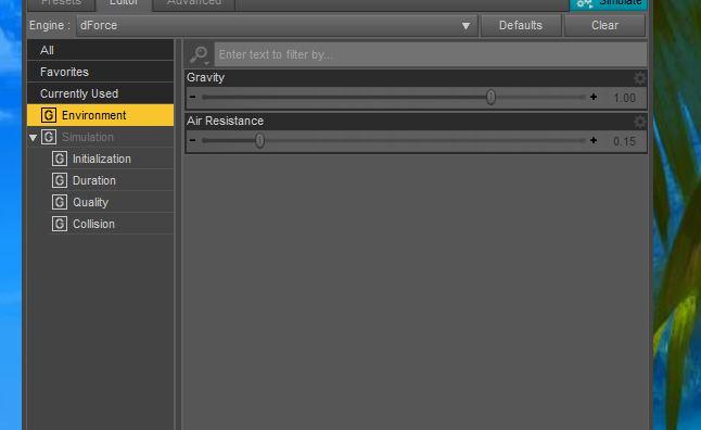

    Update:
    I tested it now with a other bed from the set and!
    Lucky I learned random that there is a Simulate menue in the surface (which also helped me at my Dress) and the Simulation was/is disabled for the top of the bed.
    See attachment.
    I dont know if this is intended from KindredArts or if ... I dont know my Lib made that O_o
    But, that is the solution.
    Edit: But it is still weird.
    See last 2 images, the weightmap is complete red, but the corners going up O_o...
    I have no idea what the surface simulation regulators do... thats too much for me :<
    Edit2: did added the material again and now is the surface correct, seems like the item did changed the surface somehow self :/
