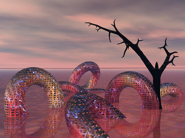

Hi, I am new to Bryce and have a question. I hope somebody can help me. I created a scene. First the sky, then the terrain and my objects. However when I render the scene I notice that a line appears on the horizon.It doesn`t look nice. I don`t know what I am doing wrong and how to fix it. All help will be appreciated. Thank you so much.

    @User #2309340 - welcome to Bryce and this forum. What you see is the bright line of the Haze in the distance. If you don't like it, you can turn off Haze in the Sky Lab. However, then all haze disappears. Haze is a clue for distance.
    You can also change its colour. In the Sky Lab, Atmosphere Tab where you find the Haze setting, click on the small white square (the colour swatch) and move the mouse into the preview to get the colour of the background. Do not forget the click on the down arrow of the preview and set it to Render In Scene.

    Hi, thank you so much for your quick response. I have used your advice and the problem has disappeared. Thank you very much!

    Another way to make the white line on horizon blend better with the sky: In the Sky Lab, set the cloud height for cumulus to the maximum value, even if you don’t use the clouds. (if you aren't using them, switch cumulus on, set cloud height to max and switch them off again). This distributes the haze more upwards instead of just a bright line at the horizon.
