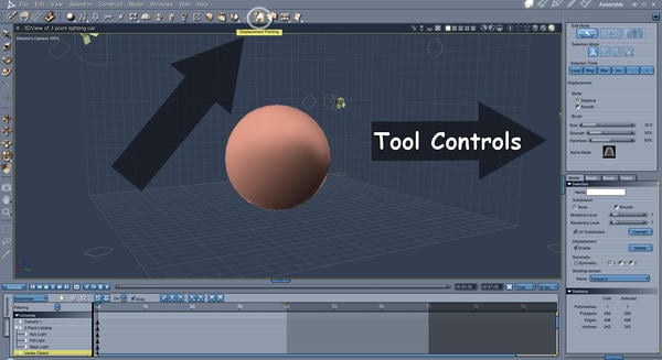

    I cannot think of one off hand. But here's a quick primer that should have you up and sculpting ASAP:
    Just glance through the images below for a fairly decent explanation of what you'll need.
    A - Find the Displacement Painting tool in the modeling tools section
    B - Select the Alpha Mask for the brush, which gives the tool texture
    C - Check that you have smoothing turned on, unless you already have a high resolution of polygons
    - Higher Smoothing (SubD) levels allow for higher levels of detail to be modeled via displacement
    - Test the tool and set the Size, Strength, and Hardness of the brush
    - Start Displacement sculpting!

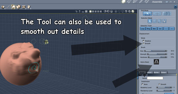

    D - The tool can be set to Smooth to flatten details that might have become too sharp

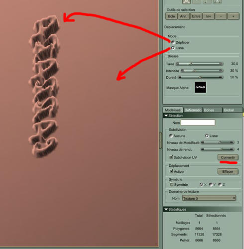

    Hello Dart,
    here a screenshot, when I select “smooth”, it doesn't have there deformation.
    My cube has ~ 9000 polygons.
    For what is used the button “Convert”?

    Not 'that' smooth... look at the same picture, down further, under Subdivision. That's the smoothing I was talking about. Notice that you're rendering at level 4, but modeling is only set to 3. So you can actually get more detail in the final render than what you see.
    That can mess things up. When displacement modeling, keep both of these values the same. You may always change them later, when you're done.
    I should also mention that, while displacement painting in this way, Left-Click builds up, while Right-Click carves down ;)
