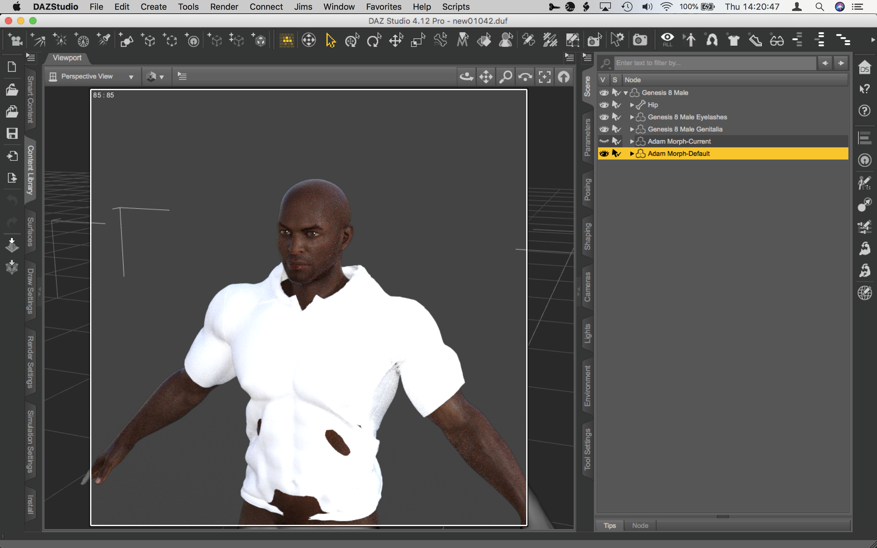

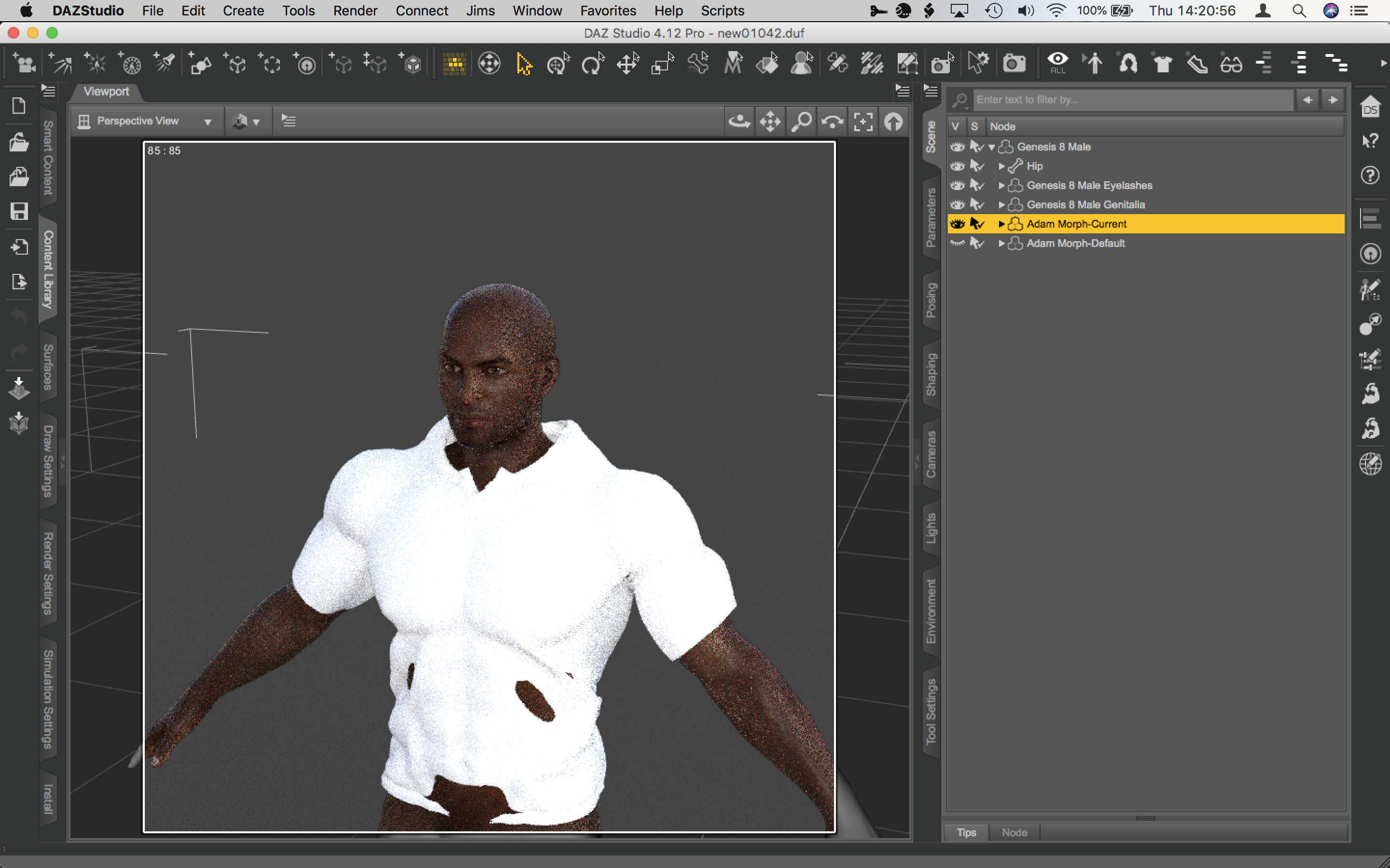

    For me, at least, I find it doesn't really matter whether I choose 'Current' or 'Default'. So, I always leave it on Default.
    You just have to import the clothing as a morph with reverse def.
    Just BTW, this was only for demonstration, this isn't my method but, ansering your question this is the best way I've found.
