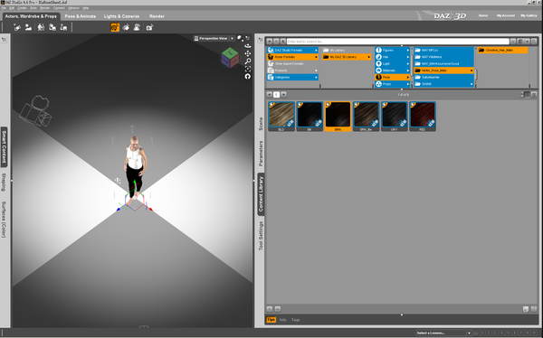

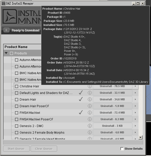

"materials are in "Content Library"... Where is "Content Library"? I don’t see that tab/button on the screen, or in any menu? I don’t even see "Poser Formats" as a sub menu anywhere.
Now as You can see, the product did install, somewhere. And it is not in any menu or tab with all the other Hair styles.

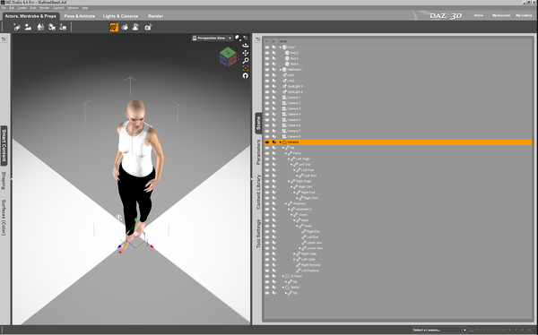

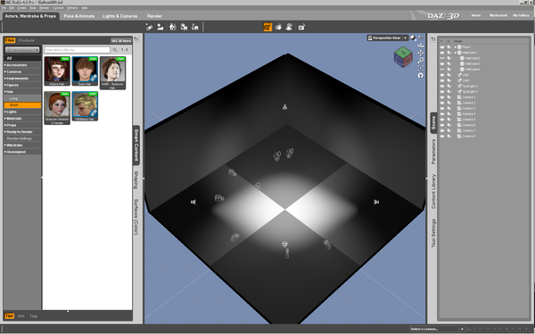

  • JaderailJaderail Posts: 0
    Umm I hate to say it but....
    1924 x 1200 - 210K

    And here I was looking on the left and top of the screen, lol....
    materials are in “Content Library > Poser Formats > [your content library name] > Pose > Neftis”
    materials are in “Content Library > Poser Formats > [My DAZ 3D Library] > Pose > Neftis”
    There is the Christine hair "Colors" from the looks of it. Nothing happened when I clicked on one, except the "New" went away, Hmmm.
    Infact there is no "Christine hair" in the scene after clicking that, as if it didn't load it.
    We doubled on that last post, lol. I have a lot of reading to do from the looks of it.
    You must first load the Hair item, those Mats are just colors to be used on the Hair, they are not the HAIR they are only texture files to change how the hair color looks.
    Look for the Hair item in POSER Formats>Hair or Figures, maybe even in Props one should hold the Hair item. You first load the Hair Prop or figure with the figure selected not the head the top figure name only. Then to change the Hair color you find it listed in the Scene tab select it and then apply a new color mat (texture).
  • fixmypcmikefixmypcmike Posts: 19,719
    The hair itself is under "Figures".

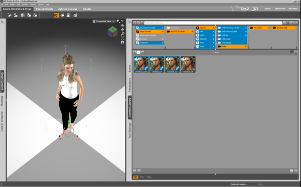

    O.K. that works, And a single screen-cap for thou's that like visual aids.
    The auto-fit thing did come up. (Sorry no screen-caps of that, it was fairly straight forward.
    Selected "Victoria4" for original intended target
    Selected "Hair > Long", then clicked "Accept", and the computer did it's thing and it worked.
    Now I can go to the other folder and select the color of choice, coolness. Can I get that over to the left thing with the other hair styles, is that covered in the two threads I haven't read yet?
    You must select the target in the "Scene" tab for that to work. Same when you go to change the Hair color, Select the Hair first after it was Auto-Fitted.

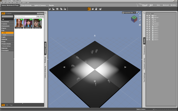

    Many of the Older items simply do not have Metadata, that is a new file that makes items work as Smart content (the right thing) It only started with DS4 and much of the content is far older than DS4. To add Metadata to things and make it Smart content is a big process and not covered in either thread or manual. I myself use all 3 methods of content views, Smart Content Tab, Content Library Tab and in that one the Products View.
