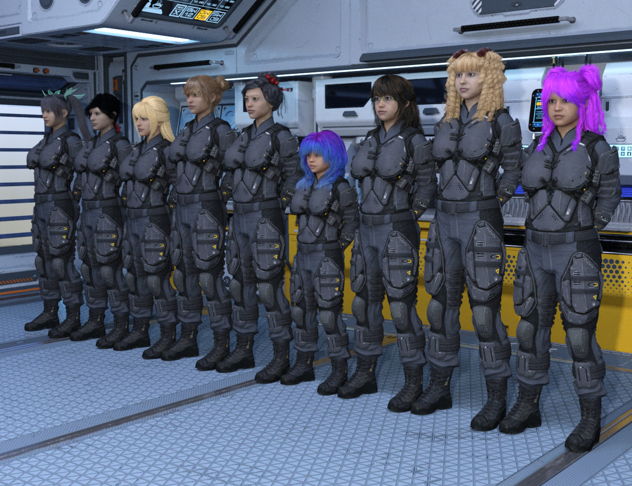

  • DarkSpartanDarkSpartan Posts: 1,096
    edited April 2020
    For what it's worth, my 1060 and I did 9 characters, with clothing and scene (etc) in ~2.5 hours...
    You're gonna need to click it to see it properly... It's a Landscape thing, rather than portriat, so the forum is stretching it.
    1300 x 1000 - 2M
    Post edited by DarkSpartan on
