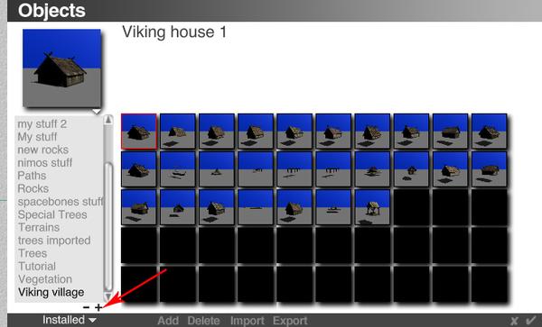

Miss B, all my .obp objects (that I placed in folders within the objects presets folder) appear to be seen automatically by Bryce without me needing to import anything. However now that you mention it I vaguely recall doing the import thing many years ago. Does it depend on which version of Bryce you are running, or is there perhaps something else I did to get it to happen automatically?

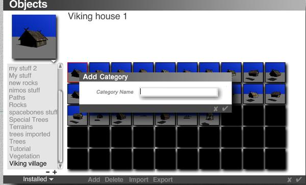

Ya know Sean, I got into 3D with Bryce 4 back in the day (circa 2000-2001), but I haven't used it since ver. 5. Back then I learned to do it the way I mentioned in my post above, but I just installed something else the way you mentioned, and sure enough it does work. In fact, it's nice because you can name it while you're at it, instead of having to stick with User. It's also nice, because you don't have to have duplicate files on your system.
Thanks for the tip. I guess an old dog CAN learn new tricks. :coolsmirk:
You can make new folders within your Object presets, even when using the import within Bryce.
Ahh yes, of course, though I usually do it under User rather than Installed so I can keep track of what "I" installed rather than what came installed with the Bryce installation package.
