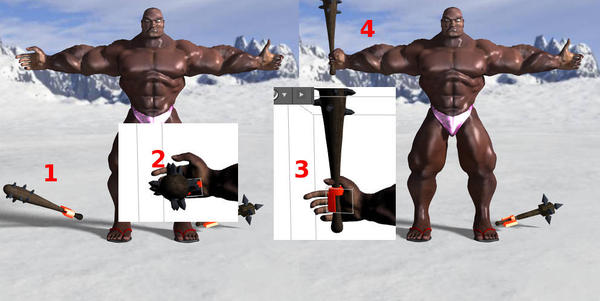

    Okay, here's what it does - first the very basic version:
    1 - the initial setup.
    - Behemoth is in zeroed pose with forearms twisted 90deg to put palms forward.
    - The clubs are from Valandars Bashers and Bludgeons.
    - The orange blobs are 'DummyHand' proxies.
    - Each club was manually positioned/oriented into their respective proxy when it was at the origin, and then manually parented to it.
    - The proxies were then moved,spun to random-ish positions/orientations.
    2 - After the "Set the proxy’s x/y/z rotations/translations to the world-coordinate orientation/position for the zeroed target figure’s hand" bit of my script.
    - The proxy and proxied club is correctly positioned/oriented for the zeroed Behemoth.
    3 - After the script parents the proxy to the hand (correctly positioned in the hand now)
    - No change to position/orientation after 'oProxy.removeNodeChild(oChild,true)' which is correct
    - No change to position/orientation after 'oHand.addNodeChild(oChild,true); ' which is correct
    4 - After the proxy's been unparented and then deleted (the script also applies a hand pose
    993 x 498 - 60K

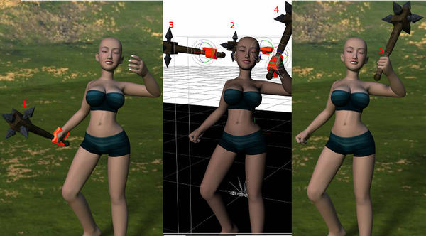

    Ah! I've answered my own question - it's doing exactly what it should, and it all makes sense now!
    1 - proxy already parented to GG3.1's right hand
    2 - proxy unparented (and thus positioned correctly for a zeroed GG3.1's right hand)
    3 - proxy repositioned (now in correct position for a zeroed GG3.1's left hand)
    4 - proxy parented to GG3.1's left hand.
    5 - after unparenting and deleting the proxy and applying the hand pose.
    And of course, it's only between (4) and (5) that I want to do things 'inPlace'.
    (and I've just realized that this will allow any figure to snatch Vicky's smartprops from her! Load the Smart+ DummyHand proxy (the orange blob) to Vicky's hand that's holding the smartprop, manually reparent the prop to the proxy, then run the script)
