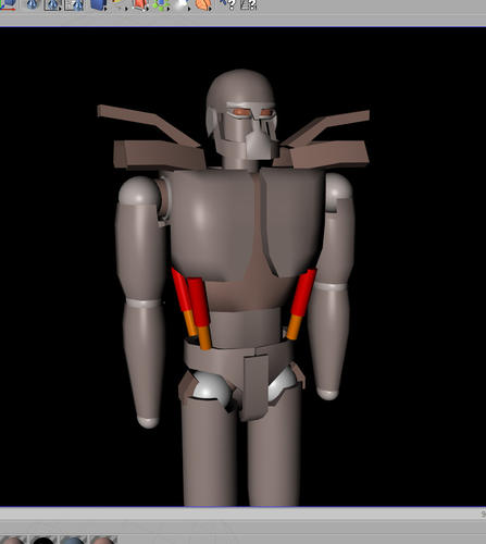

I was ruffing out a sketch of a Mech ,
Got to the stomach and wasn't sure if DAZ Studio could have all 4 of the Red & Orange hydraulics imitate real hydraulics and have them all work together.
Can DAZ Studio do that ?

  • Richard HaseltineRichard Haseltine Posts: 111,348
    In Poser and DS such things are usually handled by having two bones for each unit, one attached at the bottom to the lower joint (the hip in your example) and one attached at the top to the upper joint (the chest in your example) - the twist axis should be aligned along each cylinder, and the two parts are then set to Point At each other.

    And a classic one. Almost any robot in the store does that, such as my own modular mecha kit.
    However, be careful that the endpoints are exact on the hydraulics, and are aligned to each other. If the orientation isn't exact, the hydraulics look 'off', or 'bent'.
