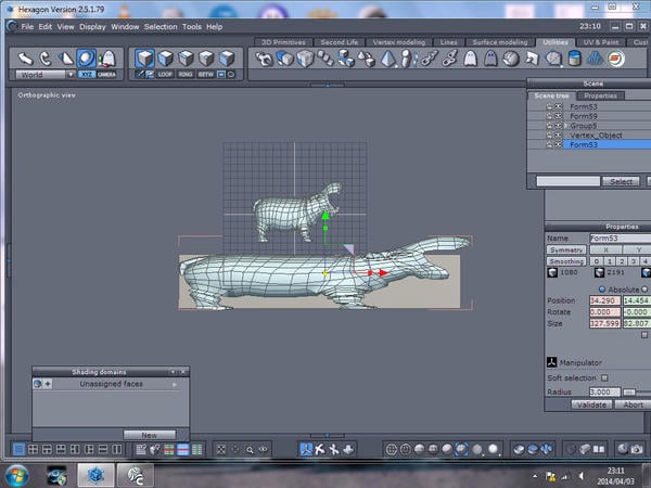

  • RoygeeRoygee Posts: 2,247
    edited April 2014
    OK - I'm getting a clearer picture of what you need to do. The final product you want is disproportional to the original, so it won't help to do a proportional scaling. What I did was import an object of known proportions, based on your 8 X 3.7 m figures and scaled the hippo to fit.
    I doubt that what you want is something like that!
    Another method is to change the size of the grid in the preferences to the largest size - 8m, so you can measure your model against that - you would have to calculate the size of the cells in the grid (grid size/no of cells) to get the other two dimensions.
    Unless your final product is a stretched out and flattened version of the original, simple scaling will not work for what you want to do - seems to me you will have to be doing some re-modeling to get it to be a very different animal. If you happen to have pictures of the two dinosaurs you can post here, that will give me a better understanding of what is involved.
    As far as the units of measurement are concerned, this is something I have never bothered with - I work with it set to cm and as far as I'm concerned, when I model and it needs to be a certain size, I take the sizes in the properties panel as being that number of cm and that is how it will work out proportionately. I have no idea why it doesn't change the sizes in the properties panel when you change the unit of measurement.
    Hopefully someone who understands this better than I can give us an explanation :)
    1024 x 768 - 175K
    Post edited by Roygee on

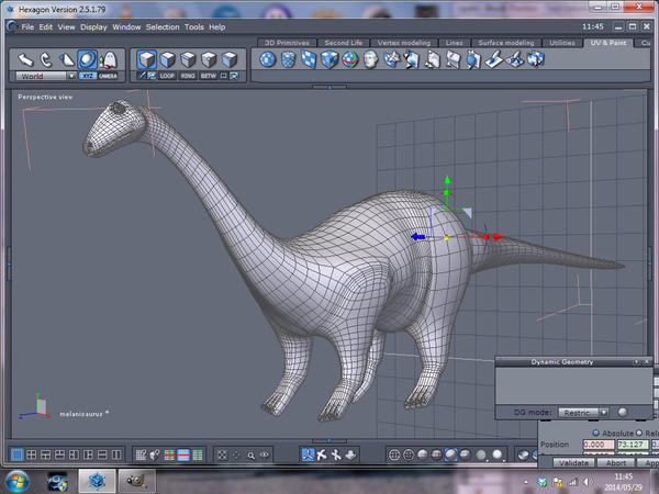

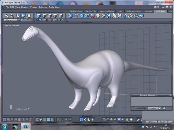

    Great - whichever method you decide on - morphing, making a new cr2 or a Tri-Az, you will have the .obj to fall back on.
    I asked this question over at the Studio forum and this is the reply I got from someone who really knows the software :-
    With older figures you can't save morph assets, but when you save a modified figure the moprh is (or should be) written to the Data folder - however loading the base figure won't load the new morph, it will appear only when you reload the saved .duf file (which you can't do). For the fourth generation figures you can use ExP exporter to create a set of files that Carrara or Poser will read; for older figures your best option is to export a CR2 which will embed all loaded morphs - you can then, most simply, import that into Carrara but you could also cut and paste the data for the new morph to an injection pose, adjusting it to use one of the blank channels in the CR2 if the fiddle was worth it.
    So, just as an exercise, and because I haven't done much organic modeling recently, I modeled this Triceratops - it needs some work, especially the feet and the head shield, but I should have it sorted and rigged both ways tomorrow, then I'll do some testing and see what works best.
    1024 x 768 - 208K

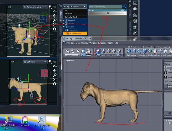

  • dinosaurmad87dinosaurmad87 Posts: 114
    Hi everyone I'm working on a Dinosaur alteration to a species I want to use in my film I altered it all in hexagon to the way I wanted it but when I send it back to Daz studio 4.6 it appears tiny? Plus al the joint bones that the model had before I imported it into Hexagon disapear (don't select) and I can't animate it.
    Anybody had this issue before?
    Chears, Ian :)
    Chears, Ian :)
    Start it with D/S.
    Send it over the bridge to Hexagon.
    Morph it.
    Then send it back to D/S and create the morph.
    If like, "save" morph.
    This might have to be done by making a new .cr2 file for it. [legacy rigging]
    When morphing the tiny figure in Hexagon, zoom in closer, do not move the figure's position "at all". Unless said movement is to be part of the morph.
    Drastic morphing will make the rigging not match in D/S. Solution tools are in the program to adjust the rigging.

    Thanks for the info and help I do have 2 pics of the 2 dinosaurs I'm trying to alter.
    (Jobaria top Melanorosaurus bottom)
    the Jobaria model is actually textured originally by DinoRaul so as I alter this model anyway of stopping the textures from stretching horribly?
    Also do you know how to select a part of an object on the model for example the whole tail without selecting face by face as it takes ages to do lol.
    http://www.daz3d.com/dinoraul I do not see the Jobaria or Melanorosaurus listed in the store. If sold at Daz3D, could you post a link to the figure(s) you're starting with?

    Jobaria is from contentparadise.com. Melanorosaurus is the species I'm altering Jobaria into.
    http://contentparadise.com/productDetails.aspx?id=16855

    It saves as a duf file. I did a save and opened it back up and it did the same again opened up as original size, not having much luck to be honest at the min with it. When I send back to Daz Studio you said t asks if I want to save it as a morph, now do I save it in group path Morphs/HexagonBridge or under a different opion if so which one?
    Plus when I send it back to daz this happens and when I start to animate too, why does that happen?
