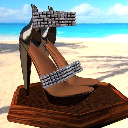

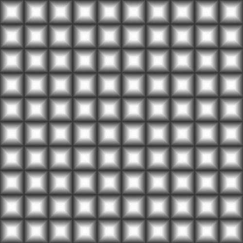

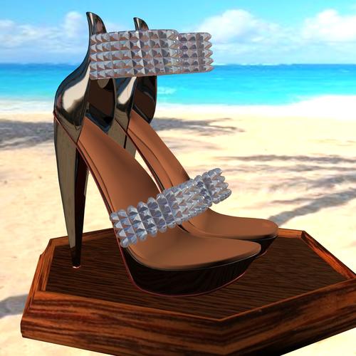

displacement map 10x10 pyramid studs for shoes and straps
mCasualmCasual Posts: 4,607
edited April 2014 in Freebies
the 3 images you see below in a zip file
https://sites.google.com/site/mcasualsdazscripts3/mcja3studs
them nice shoes for A3 dont you know are also on my site
https://sites.google.com/site/mcasualsdazscripts3/mcja3heels
note that the chrome effect is obtained using the indispensable
Ultimate Shader Pack for DAZ Studio UPDATED_2011
by Georgehaze »
http://www.sharecg.com/v/27568/material-and-shader/Ultimate-Shader-Pack-for-DAZ-Studio

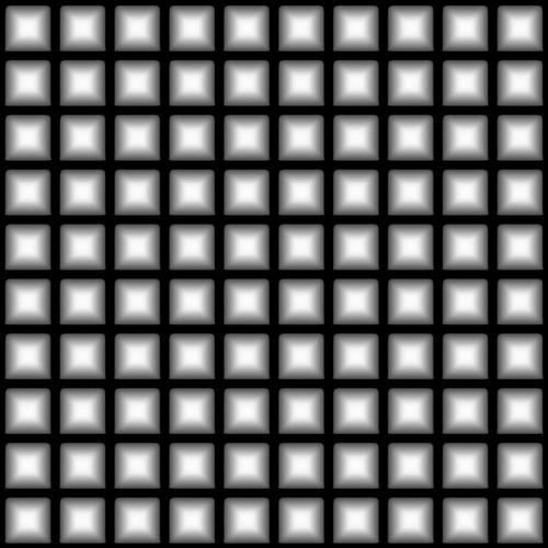

the "mask" image shown below was applied to the specular-color channel of the straps, so the chrome effect gets turned off between the studs and shows as black

    Wow, I tried your maps - excellent results, with and without the recommended shaders! Thank you very much!

    in Daz Studio's 'Surfaces' tab, if you apply an image to the "reflection" channel of a surface then, in software render mode only, you get simulated reflections, it usually looks like chrome metals
    a must-have is George Haze's free metal shaders found here
    http://www.sharecg.com/v/27568/Material-and-Shader/Ultimate-Shader-Pack-for-DAZ-Studio
    so i applied a chrome shader like that, then added the pyramid studs displacement map
    then i applied of the 3rd image shown above to the diffuse map
    http://www.daz3d.com/forums/index.php?&ACT=50&fid=41&aid=134047_BNzhJI03et8VFf1jfOGf&board_id=1
    to get black lines between the studs

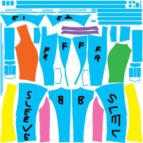

  • ScavengerScavenger Posts: 2,677
    I guess I just don't understand. This seems to be different than other surfaces and maps I've experimented with.
    I've taken templates or already made texture pictures and put them in the diffuse map area. This gives the...picture..that gets rendered.
    Then things like displacement or bump maps get placed in the right slots to give the picture texture.
    What I was hoping I could do is use these, by slicing and dicing and applying them to a template in photoshop, to make a texture for a leather jacket, ala the picture attached.
    SO, if I understand how you did it, The shoes in the sample pic, the ankle band you applied the chrome shader, then put
    mcjStuds2Mask.jpg in to the Reflection Map field.
    You then put mcjStuds2Bump.jpg in the Diffuse field.
    SO, THE DIFFERENCE, between mcjStuds2Bump.jpg and mcjStuds1Bump.jpg is how much space is between each stud?
    Hmm..If i now understand everything correctly, then this will either not work, or be a lot harder than I thought it would be to do.

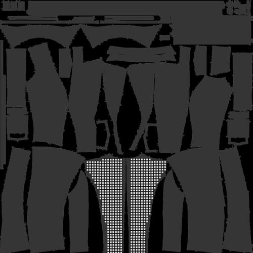

  • mCasualmCasual Posts: 4,607
    edited October 2014
    Scavenger said:
    the chrome shaders make all the selected surface chrome
    studs2bump is applied to the displacement map of the shader
    ( it works with the bump channel too but the results are not as realistic
    the displacement strength needs to be 100%
    the displacement min can be 0 and the displacement max can be 1
    this means the studs will be 1 cm ( 1/2 inch ) tall
    the "mask" is used to to add black lines between the studs
    so it can be applied to the diffuse channel
    or possibly to the reflection strength channel

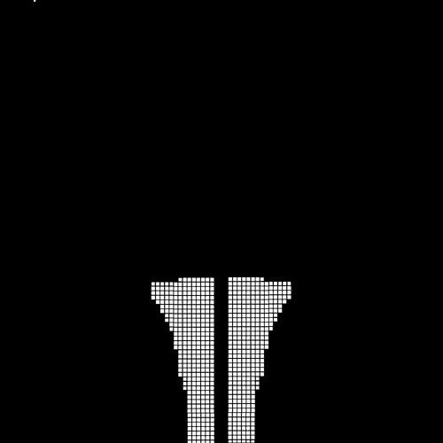

    all this works fine with the shoe straps because their textures occupy the whole surface
    in the case of your jacket you'll have to do a good photoshop job
    example of what your displacement map and deffuse or reflection-strength map could look like shown below
    note that it's better if the areas shown in dark grey are in fact black
    i left them like that so you could recognize your pattern
