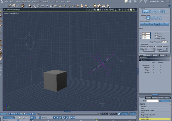

Hi, I'm trying to follow a vertex modelling tut by DimensionT but unfortunately he doesn't explain how to get to his starting point - which is the modelling room with a load of tools across the top menu bar, this is what I see:
Can anyone tell me how to get my screen to have all those modelling tools available that he has in his screen?

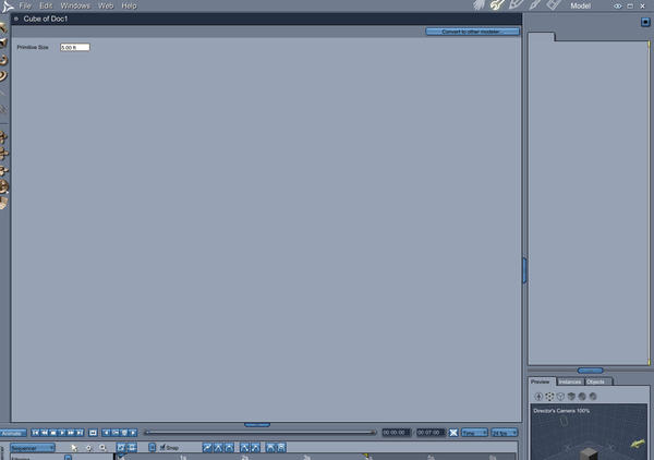

  • franontheedgefranontheedge Posts: 342
    edited April 2014
    You're probably clicking the wrench like I did many times at first.
    After you create a new project, click on the Vertex object icon (looks like a distorted globe) next to the cup, then click in the work area. The screen will change to the model room.
    Or choose Insert > vertex object. This will open the model room, too.
    Thanks for the reply.
    Yes, I did click the wrench. Seemed logical at the time. But I'll do as you say....
    er... I did just try that and although a lot of things did change - it still says 'Assemble' at the top right, not 'Model' so where am I now?

  • That Other PersonaThat Other Persona Posts: 381
    I see what you did. You created a cube in the assemble room and then clicked the wrench (sorry, I said I am still new at this).
    The tut probably wants you to create the cube in the model room.
    I see this:
    1266 x 891 - 198K
    Gosh! It makes that much of a difference?
    So should I go back and delete the cube and then click on 'Vertex modelling' and THEN create a cube, or what?
    You type faster than I can!
    Yes.
    Delete the cube you made in the assemble room and then click the vertex object icon (the distorted globe) then click in the work area. That will change you over to the model room.
    Once there, you will again have the cube-sphere and whatever icon at the top. Choose cube and then click the work area.
    Your new cube will look very different from the one in the assemble room (a primitive).

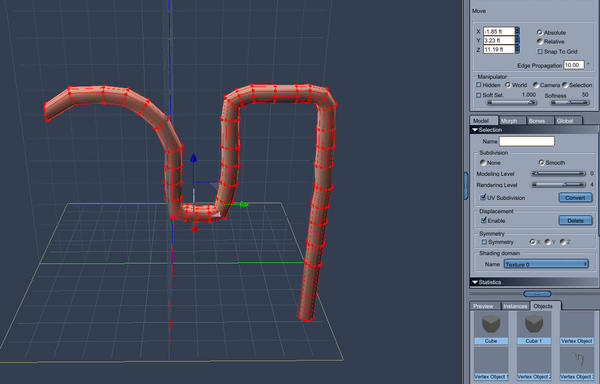

    I've just let the video run through a bit more and I can't wait to try out the various spline effects... In fact I just did. Love the method for making wiggly pipes! Weeeheee!
    I do have a question though:
    over on the bottom right I can see 2 cubes and 3 vertex objects? Yet looking in the scene there's just the wiggly pipe.
    Now I deleted the cube, and the spline that made the pipe (but not the circle I used to sweep around the spline) so what are all those things over on the bottom right?
    1075 x 688 - 120K
    Post edited by franontheedge on
    edited April 2014
    Ahh... that window! Yeah, that confused me for a while.
    Go up to Edit > Remove Unused Masters > Remove unused objects.
    I saw somewhere that if you delete a lot of objects memory can become a problem so you may need to delete unused masters from time to time.
    Dunno.
    Post edited by That Other Persona on
    Dunno.
    Okay....
    I just tried that - but that option is greyed out - how do I get it to be available?
    (By the way - do you have a link to the tutorial you followed on polylines?)
    Dunno.
    Okay....
    To remove those things you need to be in the assemble room.
    I have seen several polyline tuts online but I also bought a few tuts at the Daz store to save the hassle of searching. I saw the one you are working through now (just checked). Part 2, too. Can't recall if Cripeman did one... Check for Cripeman on Youtube.
  • 3DAGE3DAGE Posts: 3,321
    HI Fran on the edge :)
    When you insert a "Primitive" object such as a cube,. you're adding a pre-set object,.. (which could be converted to an editable model) but by default, primitives aren't editable as models. they'd need to be converted to another modeller before you could edit it,..
    (EDIT / Convert to other Modeller )
    It's easier to simply insert a new vertex model....
    From the INSERT menu, you should select "Vertex Object",. and that will take you into the Vertex modeller to begin creating a new vertex model.
    Once you're happy, you can return to the Assembly room by either closing the vertex modeller, by using the little round icon in the top left corner of the screen,..
    Or,. by selecting the "Windows" menu, and choosing Assembly room
    you'll also notice that you can select and jump to the other rooms from the Windows menu,... Modeller, Storyboard , Texture, Renderer.
    If you already have a Vertex model, in the assembly room,. you can select it and hit the Wrench icon (to edit the model)
    Or simply double click on it in the Scene or (Scene Instance list) on the bottom right hand side, which lists all the objects in your scene.
    In C8 and 8.5 you can also edit vertex models inside the assembly room, by using the Wrench on the top left of the screen
    Hope it helps :)
    In Carrara, you can create multiple objects , or load objects, then decide to delete some, and then decide you didn't want to delete all of them. so.. Carrara keeps all the Scene items you create or load into the scene, in the Objects panel, and the Shaders panel,. (bottom right panels)
    For example, you load a figure,. then add some clothes and then decide.. no,. Delete them and load different clothes, then you load textures and change the original textures for something new... then you decide you like the first thing you loaded,. it's still there, it's just in your Objects panel, not in the scene. so you can drag and drop from the panel into the scene.
    The drawback to this is that the scene can have a lot of Junk in the objects and shaders panel,
    To clear the Junk from your scene,. Go to the EDIT menu, and choose REMOVE UNUSED / Objects, then repeat that for Shaders. and Clips,... if you've been making animations and saving them as NLA clips.
    You can clear out the unused objects and shaders whenever you want, at any point in your work,. but once they're gone,.. you'll need to reload any of them from your browser if you want them back in your scene.
    It's a matter of good house-keeping to regularly Clean out the Unused,.. then save your file.
    if it's a Big or Important project, save regularly, and save with a different file name after you make any major changes or edits.
    You need to be in the main "Assembly Room" to be able to access the EDIT / Remove unused /
    Oh is that what that means? Lol! I thought it meant 'switch to Hexagon' or something like that, and I very carefully avoided it... Roflmao!
    Uhu, as I found out yesterday. Especially as I didn’t know how to convert an uneditable object into an editable one. So thanks for that.
    Hope it helps :)

    This wrench becomes a hand when you are in modeling mode in the assembly room. To return in assembly mode, you click on this hand.
    Yes, I know, I can't remember exactly what was happening yesterday when I couldn't get to the modelling room with an editable model, but at least now I know how you CAN get to the modelling room with an editable model.

    One More Question:
    How do I add a loop of verts around my wiggly pipe? I want to firm up each end - where it looks floppy.
    Or else 'Bevel'?
    FranOnTheEdge
