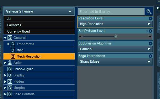

    To check it,,
    change your parameter tab show "hidden parameters" and go to Currently used.
    you must need to use default genesis2female.duf then make shape I think.
    (because Currently used, only show parameter which value not same as "default value"
    some character preset.duf may change default value I think, then about these case currently used
    can not show the parameter as used)
    then if your genesis2female, change other parameter (usually resolution lever),
    you need to reset all these parameter as default, then you can see only morphs and rig movements
    in Currently used section.
    my pic show genesi2female default setting ,, you must keep this setting,,
    (though you can not believe or not,,)
    After that it work (usually,, but I can not confrim if there is other reason,,to break )

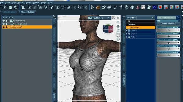

    Though I tried with many option setting, (sometimes use template, sometimes use Actor,
    sometimes not transfer any morph etc,,or change morph type etc,, ) already.
    I mix my character shape about 5 morphs then test again and again with many option.
    At leaset,, If I change genesis2female Resolution level to base,, with same option setting TU,
    It seems double up all morph how I tweak other option. with Current and remove shape conbination
    add Pic,, sucess case with many morph and remove shape option,,
    (in my directory,, now there are too many pic with many setting and failed TT;)
    1168 x 650 - 128K
    510 x 316 - 37K
