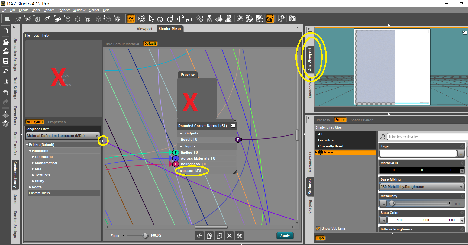

    Are you still trying to work in Iray materials? That isn't an Iray material, it's 3Delight. Look at the top of the taller brick ("DS Default Material" is the default 3Delight shader) and at the bottom (RSL is the shader language used in 3Delight shaders, MDL is the one for Iray). If you have an Iray material applied to an object in your scene, and you want to work on it in the Shader Mixer, you need to import it using the File menu IN THE SHADER MIXER PANE — NOT THE PROGRAM FILE MENU.

    And as I said, no we don't, not for Iray. We use the Aux Viewport. Works well.

    Thanks, Catherine. I forgot to switch to mdl for my screen capture but even when I select for mdl the previews tabs are still shown. In your capture you placed red Xs over them, but the software doesn't inactivate them so I assumed they were functional. I'm still new to Daz and I don't usually play with the shader mixer but I was using it to make sure I had my vmaterials directory linked correctly. Hit preview on a whim and received the same crash notice I am receiving when I try to render with Iray.

    Yes those fields are still there, I put the red Xs because no they are not going to work with Iray. Totally different render engine that what those fields were designed for [in my layperson's terminology].
    Okay, if you pointed the directory to where the .mdl files are located, that is all that you needed to do with Shader Mixer. Presupposing that you have been downloading the shaders I've been putting together and putting that content in the right folders, when you select an object and a surface, the shader will apply.
    And of course all the purchased Shaders from the Daz3d store should work as well. Those are not dependant on the vmaterials from nVidia.
    One thing that will knock D/S out is if one renders 3D materials with Iray or vice versa. Not always ... but there are these eyes on some cat that will do it everytime.
    Check the render settings before running a render, and before creating any new primitives. Primitives are created with the shader applicable for the render engine selected.
