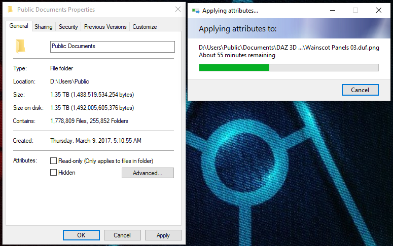

    3. I brought up the properties of d:\users\public\documents ... it was marked "Read Only".
    4. Turning off Read Only on several hundred GB of files and folders now. Will update once that's done.

    First, I was just a bit off on how large my Daz library has gotten. :) Basically my "d:\users\public\documents" folder is ONLY my Content libraries.
    Second, I think I figured out what happend. Windows 10 / OneDrive decided to be "helpful" by configuring my MyDocuments folders to be "backed up" to OneDrive. The problem is, I had already redirected them myself to OneDrive. So all of a sudden OneDrive's Backup feature tried to take control over the folers I had redirected there to treat them like backups which should be ReadOnly. I had to disable the "backup" feature of OneDrive and now I have other folders which also need to be fixed.
    I know they were trying to be helpful, but I wish they'd asked me first before marking all my documents and folders "Read Only".
