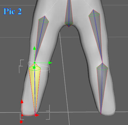

I have a problem with this tutorial.
On page (either 26 or 30 depending on if it’s a number actually printed on the page (26) or the page number that’s in the thumbnails list on the left - then it’s 30)
The instructions say to:
“Now, on the shin bone, move the end point so that it is centered at the bottom of the shin, and align that bone as well.”
Well I selected the shin bone, but when I tried to move the end point at the bottom of the shin, (where the foot would be if the figure had a foot) a red axis thingie moved but the bone did not.
See Pics 1 & 2.
I tried moving the top of the shin bone, it did move but that’s clearly not the bottom - I’m so confused…
How can I move the bottom of the shin bone? Help?

  • Richard HaseltineRichard Haseltine Posts: 111,996
    Having moved the end point you then need to click the Align button in Tool Settings, which should already have been covered by the way the excerpt is phrased.

  • franontheedgefranontheedge Posts: 342
    Oh you mean the fact that moving the end controller doesn't actually move the end point itself - is SUPPOSED to happen???
    Good grief!
    I'd stopped at that point because I thought I'd done something seriously wrong.
    I've never done any rigging in DS before you see - and in C4D where I HAVE, moving the 3 axis controller actually moves the end point of the bone - at the same time!
    And to align (in C4D) is talking about rotation, not movement, so this is very confusing.
    Thanks for clearing that up.

    The end point (the red circle with axes) should be moving, and is in your screenshot, but the bone doesn't automatically snap to it (unless you turn AutoAlign on). Moving the centre point (green circle with axes) does move the whole bone.
    Yes, I got that from your last post - but that's not obvious if you don't know that. And that's why I was so puzzled. Really thought I'd broken something somehow.

  • kitakoredazkitakoredaz Posts: 3,526
    the rigging tutorial is very kind and easy to follow for most of new users.
    She clearly mentioned many times , we need "Align node"
    she adjust shldr node, ,
    Click on the rShldr part (A). Use the translation arrow to move the starting point of the bone up a little (B). You will notice that the end point is no longer aligned; right-click on the bone and select “Align” and “Align Node.” The bone will now be properly aligned (C).
    then adjust hip, she mentioned again
    Align the bone (right-click> Align> Align Node.) then
    after that, she adjust shin bone, as you moved.
    If you follow what her mentioned one by one, you must find,, you need "Align">"Align node"
    after you move node end points.
    I usually just follow the step which written in document, when learn from it.
