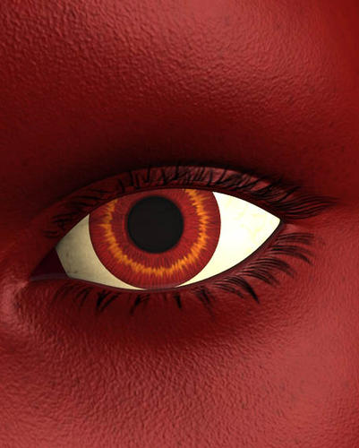

Hello,
I've tried so many things to get rid of the pixels in the eyewhite as seen in the attached file.
Smoothing is on and i use the UberSurfaceShader on genesis with M4 uv-map and completely basic (no addons morphs or anything at all).
Increase or decrease of shading rate, shadow samples and there was a few more things like bucketsize turned out fruitless.
I use completely homemade textures and have used a tutorial called "Gimmie some skin" by Toadz on Deviantart to get to know the SSS. Those two and a few other can be found here: http://toadz.deviantart.com/gallery/43374043.
Does anyone know how to solve my problem?
531 x 569 - 214K

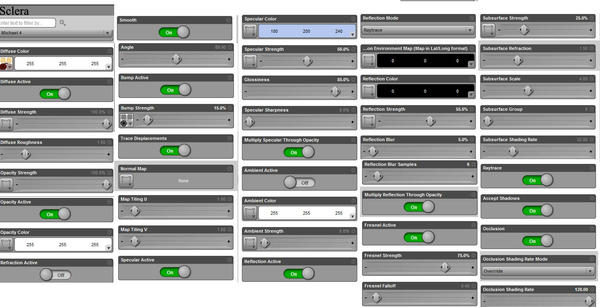

    I'm not sure how I can show full settings. I cobbled together a screenshot from the ones from the sclera that seem to be the trouble area.
    Sclera
    Bump min & max unchanged. Displacement flat and unchanged. Anisotropic and specular 2 off. Fresnel sharpness off. No velvet or translucent.
    1503 x 768 - 212K
    489 x 768 - 85K

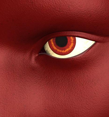

    I lowered the occlusion shading rate to 10. I might also have poked at something else in between. I tried different displacements and bumps and they affected a bit as well.
    A bump on 100% gives the lower result with occlusion shading rate 10 give the lower image.
    456 x 569 - 181K
    456 x 569 - 178K

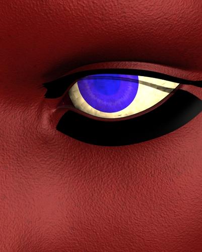

    Today (2014 may 09) I decided to put the same things on a new genesis figure.
    When I applied the uberenvironment2 lights the eyewhite pixellated. It's okay when I do not use UE2.

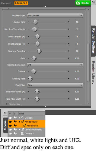

  • JaderailJaderail Posts: 0
    Your Uber lighting Samples is TOO low. I use 64 or 128 for my Uber lighting Samples. That equals the High quality setting or the Very High Setting.
  • BronzewingBronzewing Posts: 0
    Thank you very much everybody and especially Jaderail!
    Now it looks like this and I was so happy that it worked that I touched my drawingpads pen onto DAZ. DAZ hates when I do that and collapses so I had to remake the setting but that was not hard att all now when I knew what I should adjust.
