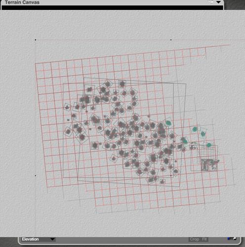

Hi all :)
I'm making some progress - made a reasonable terrain with a river running through it (water plane intersecting terrain) Now I want to populate it with some trees - the process is straightforward enough - the problem I'm having is how to paint on the terrain without including the underwater part, as there is no 3D view in the instancing lab.
In the video I'm following, he has blank gaps in the terrain mesh where his lake is - see attached, so he can see where not to paint.
How to get those gaps? I thought that by booleaning the terrain with a flat one to match the water plane, this would do it, but it just shows as a square overlaid mesh in the instancing lab.

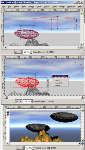

    I haven't actually read any tutorials. I just experiment and play, as is my normal habit.
    These are taken form my latest landscape image
    Terrain in terrain editor
    Terrain in instancing lab
    Terrain from above with trees painted

    Yes, the way to do it is to use the clip filter in the terrain editor. Bring up the red bracket from the bottom to cut off the lowermost section (in your case, the part of the landscape which is to be below the water. After you have instanced, you can move the bracket back down to reintroduce your lake bed if it's needed.
    I think it also shows and works correctly if you have Bryce set to not show what is under the ground plane and you use the ground plane as your water surface. EDITED TO ADD: It looks like that's what Chohole has done in her scene above.

  • bighbigh Posts: 8,147
    good show and tell

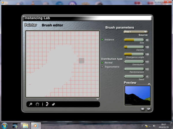

  • Rashad CarterRashad Carter Posts: 1,837
    Roygee,
    I'm so annoyed right now. I spent well over an hour preparing a response to get you going but the forum ate it, its gone now. and I'm gonna have to rebuild some of it.
    I'm so glad to see you are working with Bryce and especially the Instancing Lab. Admittedly, Bryce 7.1 is the first version to implement a feature such as this and for that reason the feature is quite incomplete, still very immature compared to the elegant Surface Replicator system in Carrara. Still with understanding, the Bryce Instance Lab can do great things. A few things to keep in mind as you study:
    1. The Preview window of the Instance Lab only displays polygons which have an altitude higher than 0.00 in the Bryce world. Polygons below 0.00 are not displayed, but that does not mean that instances cannot be painted onto those areas, that is why terrain clipping is the only way to be certain no instances end up in areas where they are unwanted. Removing unwanted instances manually has many shortcomings including leading to possible crashes, so its best to avoid painting into unwanted areas in the first place.
    2. Grouped Objects don't rotate properly in the Instance Lab due to a nasty bug such that once you finish rendering you come to see that all of the instances of the group are facing in the exact same direction. The only solution is to create multiple versions of your original source object, each rotated slightly differently. You will then simply apply each as a unique brush source and paint away. It is also important to note that single mesh objects rotate just fine. So if you are dealing with OBJ models, it is best to consolidate them into single mesh objects whose material zones do not overlap on the page. If the group is imported as a single material zone, rotation in the IL remains consistent. I should also remind you that you can use instances as source models for further painting. This is a good idea at a time such as when working with groups.
    Imagine for example you wanted to populate the Bryce scene with highly detailed (polygonal detail) pine trees you modeled in Carrara. For this example we will assume that Carrara exports this model in obj format with three material zones, base/trunk/leaves. When you import the obj into Bryce you will end up with a grouped model made of the three distinct material zones represented as individual mesh objects. Select the complete tree, then un-group it but keep the separate parts as an active selection. Then scroll down the Edit Menu (Edit next to File) and you will see there is an option near the bottom to Instance the current selection. When you apply this you will see a new instanced version of your original tree, all three parts in the proper relationship to one another. Simply group these instanced pieces together to create a new instanced whole which we will call Sample 1. Remember to go back and re-group your original tree. Now you have two version of the same complete tree. Give the original tree and the subsequent sample tree or trees unique rotation settings. Now when you enter the IL (Instance Lab) you will apply the Original and the Samples as unique source objects. The result when rendered will look like the original tree has properly been rotated by the IL. It is smart that Bryce allows instances as sources, If you would have had to replicate this high polygon tree the traditional way to create the rotated sources, you would waste lots of memory.
    As mentioned earlier, single mesh objects rotate just fine so 99% of the time I consolidate my obj models from multiple material zones to a single material zone. When I import the tree into Bryce I will select the top option of Material as my import method, which allows Bryce to import the tree as a single mesh object. Clearly, this approach requires that you get all of your uv mapping completed before exporting from Hexagon. The material zones need to be free from any overlaps. I usually put my trunk materials on the left and my leaf materials on the right. Anyhow, once consolidated, the new single mesh tree will rotate as expected in the IL without any extra steps and hoops to jump through.
    3. Careful with clipping. If you alter the clipping of a terrain while it still has a group of instances attached to it, Bryce will surely crash. It seems that Bryce assigns the positions of the instances on the terrain surface by vertex and polygon number, such that each instance knows which polygon number it has been assigned to. If you alter the clipping while the instances are still attached to the terrain, the instances get confused about where they belong so Bryce crashes. It is best to un-group Unnamed as soon as you exit the Instance Lab. Now the link between the instance group and the terrain is broken so you can safely edit your clipping without a crash. Once you are completed with all painting operations it is then safe to re-establish the link between the instance group and the terrain.
    4. When the wireframe view gets extremely detailed as it does in cases where there is lots of instancing; the navigation of the camera and the entry into the labs becomes incredibly slow. There is an elegant solution. Before you begin painting you want to prep your source model. In the Attibutes ("A") of the source model you want to enable "Show as Box." This setting will carry over to the child instances, placing a simple box in place of the more complex wireframe representation of the model. With thousands of copies per scene this show as box setting really helps keep the wireframe complexity to a minimum thus keeping the navigation speed acceptable. I also think assigning family colors before you start painting will be a smart move down the line.
    Lastly, there is a serious bug with the IL where the linked materials of the source and the child instances can be broken. This break occurs every time you save then re-open the scene. Let me be clear. After a scene with instances has been saved, closed, and re-opened you will notice a huge memory increase. I consider this increase to be a leak. Typically, each object in a scene has its own piece of memory assigned to it which it activates to access the Materials Lab. During the original painting session, the instances do not have their own individual memory allocations for materials, because the software knows to simply reference the memory assigned to the original source, so total memory usage remains quite low as it should. When scenes have been re-opened the link between the material setting of the source and those of the instances becomes broken. This elevates the instances from completely virtual as they were during the original painting session into being partially real. Instead of sharing the same Material Lab memory chunk as the source, now each instance has its own Material Lab memory chunk, which means a huge increase in memory of roughly 500%. If during the original session you had painted 100mb of trees, you will find upon re-opening that the memory usage has jumped by 500mb. This jump is due to the fact that now each instance has its own piece of memory which it needs for its materials. Fortunately the geometry link between source and children never breaks even after saving and re-opening, so memory usage doesnt completely explode even further. Still, a scene that seemed fine before saving could fail to re-open reporting a memory error if you forgot to leave some extra head room. Another consequence of this break in materials referencing is that editing the source no longer updates the instances, you must update them individually which can cost a ton of memory and even lead to out of memory crashes.
    This is a much less comprehensive response than what I originally wrote up. But if you read the tutorial Horo mentioned along with this current post it should get you moving in the right direction.
    As you continue working with Bryce you will likely observe how desperately we NEED an update to Bryce. The neglect Bryce faces, where bugs such as the group rotations and materials link failure really put the brakes on creativity and usage of features. If only we could get some stuff fixed, life for Bryce users would be so much easier. I'm just tossing that in for some perspective on why so many things seem backward in Bryce, yet we still love it and want it updated, not tossed away as a lost cause.. If Carrara is under-updated, Bryce is in an even worse state. Let's hope that all changes someday. But I doubt it. Both Ds and Carrara are both slated for updates but still nothing for Bryce. By my count we are getting close to 4 years without any real investment from Daz. Arggghhh!!!
