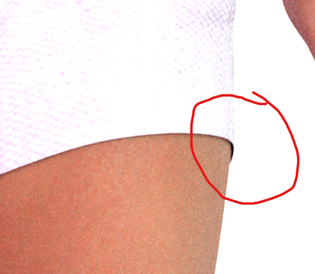

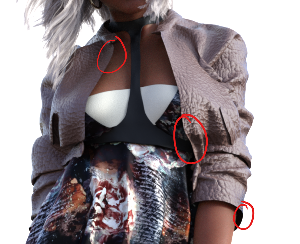

  • sunnyjeisunnyjei Posts: 502
    felis said:
    Maybe try to post a screenshot. Then it will be easier to suggest.
    I took a couple of screenshot and tried to highlight points
    To give an example of what I am after this is a product Peache (love Peache's stuff!). I'd like to be able to create more depth like Peache's clothes appear to have in this photo. (Look near the ends of the garmets by her wrist, thighs, and belly- even the shadow on her thigh seems to support the illusion of depth) Hope that helps! :)
    1017 x 827 - 985K
    622 x 540 - 361K
  • felisfelis Posts: 6,361
    That is the edges you're have marked.
    And in order to get that real geometry is needed, meaning you can't just take a piece of clothing and get that.
    cool i'll add that then to the list of daz related stuff to figure outwink
