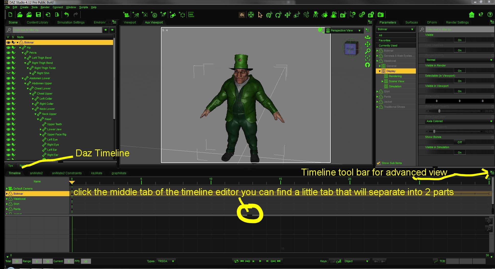

@kwannie on the side tab you will find the timeline tool bar. click it and make sure you have "advanced view" check
Then when you open the daz studio timeline down on the very bottom in the middle of the timeline editor you can find a little tab that will separate it into 2 parts the graph editor & the keyframe editor its kind of hidden so you have to feel around for it
Hope that helps

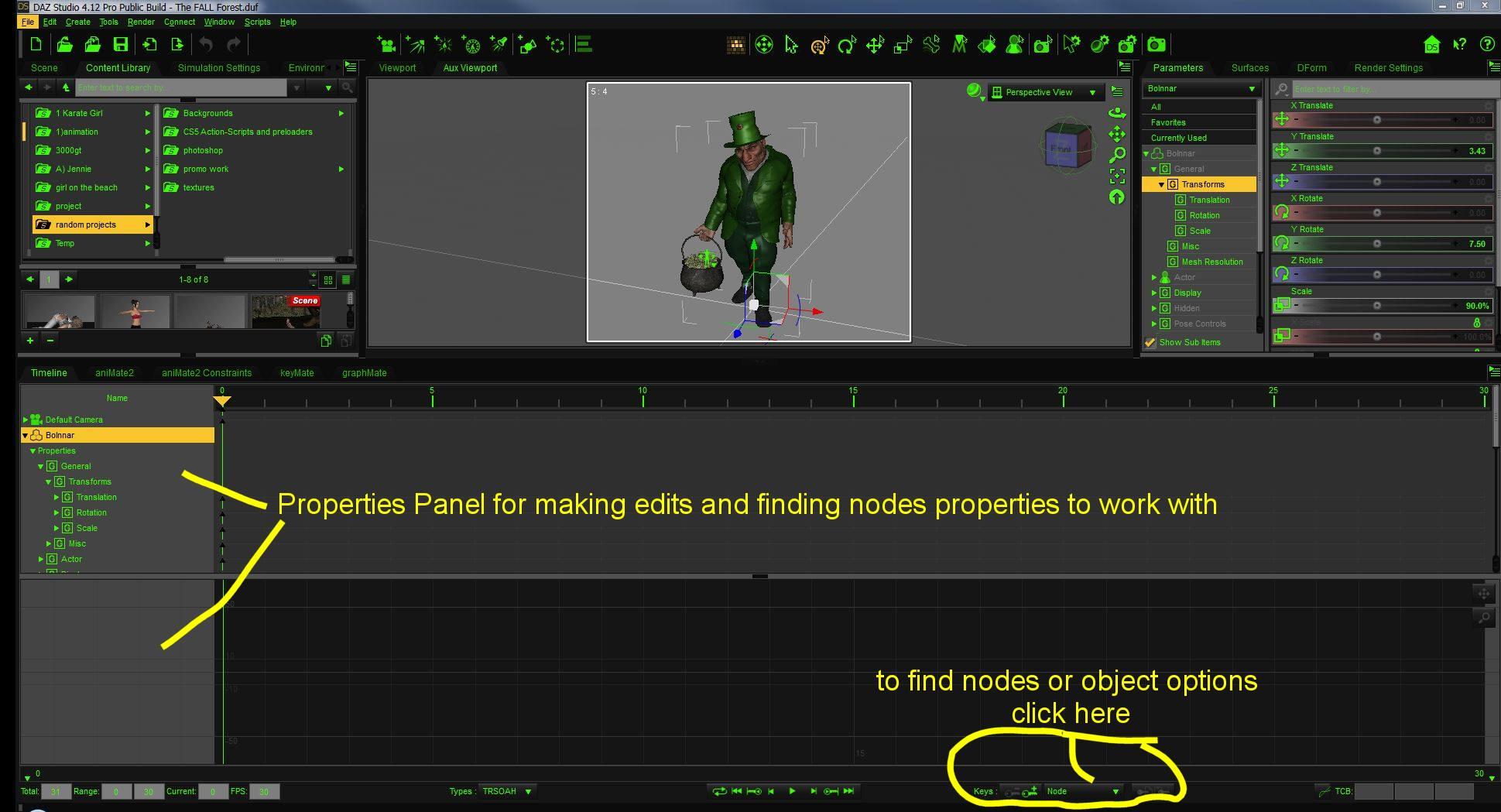

If you click character or prop and look on the left side panel on the daz timeline you will see the respective properties so can click each part to expose the bone rotation /translations work with ik-chains & nodes you can use those properties to make edits and adjustments. To Access the Keyframe Nodes click the tab on the buttons of the timeline circled in the screen shot . that tab allows you to choose different options for working with .also some of those nodes you click you can make edits under the main parameters tabs as well .
