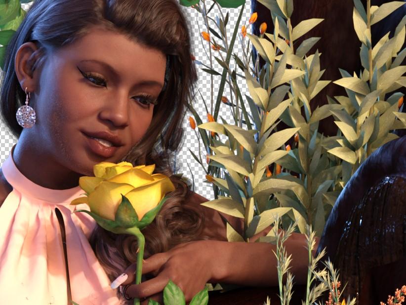

    Thank you all very much! This is a crop at 100% zoom. It took a little over 24 hours, 5k iterations, and 96% convergence.This is my clearest/least nosy render to date the peach fuzz even showed up on her face :D Excited to edit it a bit in Photoshop but overall really, really pleased with how the full render turned out.

  • fastbike1fastbike1 Posts: 4,084
    @sunnyjei "overall really, really pleased with how the full render turned out"
    By Jove, I think you've got it!  wink yes
  • sunnyjeisunnyjei Posts: 502
    Thank you- I consider it a team winheartlaugh
