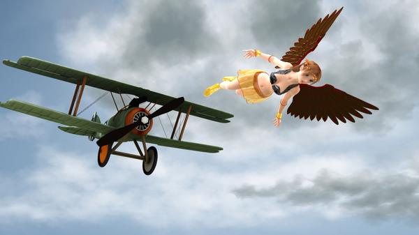

Am hoping to get the rudder section of the plane in motion, just to finish off this piece of artwork I have, how do I do a circular blurry motion of the rudder in flight?
I have the latest Artrage, Photoshhop CS6, DAZ Studio, Bryce, Hexagon,etc. Would I have to postwork this in, and if I do - how?

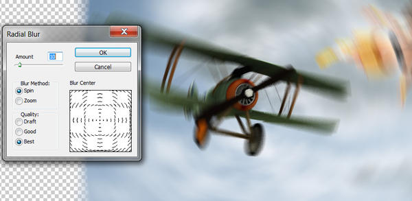

    I duplicated the layer and masked out a roughly circular area.
    Used Filter/Blur/Radial Blur.
    Then reduced the layer opacity to let the original show through as much as necessary.
    920 x 347 - 52K

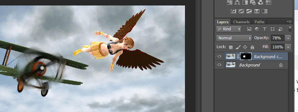

  • prixatprixat Posts: 1,627
    Hi weavo
    With your duplicate selected, use the elliptical marquee tool (M) and just draw the circle you want.
    Then on bottom row of the layers palette you click on vector mask (to the right of the fx button)
    That will create the 'mask with a hole' in one click.
    The only fiddly bit is finding the center of rotation of the blur.:cheese:
    You can try moving the center in the filter but it was easier to use the move tool (V) and move the layer, try the blur, remove the blur and repeat, till I found the center.
  • Edd_ weavo-1Edd_ weavo-1 Posts: 38
    Gave this a go what you think?
    1010 x 568 - 84K
    Looks good but is it too subtle?

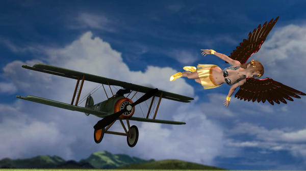

    Have done a better version, just gotta sort the propellers again, added more to background.
    Getting there, what was the angle you used the rest of it to create that spin perfectly in radail blur options?
    1010 x 568 - 70K

    These were my settings for Radial Blur:
    864 x 422 - 90K

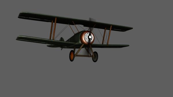

    Very quick effort all in Daz Studio:
    Load and position biplane.
    Set Spin parm to 90 in frame 1.
    Set frame back to 0
    In advanced settings, check Motion blur, set Motions samples up (I put it at 16), Motion Amount to 33%
    1234 x 694 - 101K
    Found it in DAZ studio. Thanks!! just gonna render it now.
