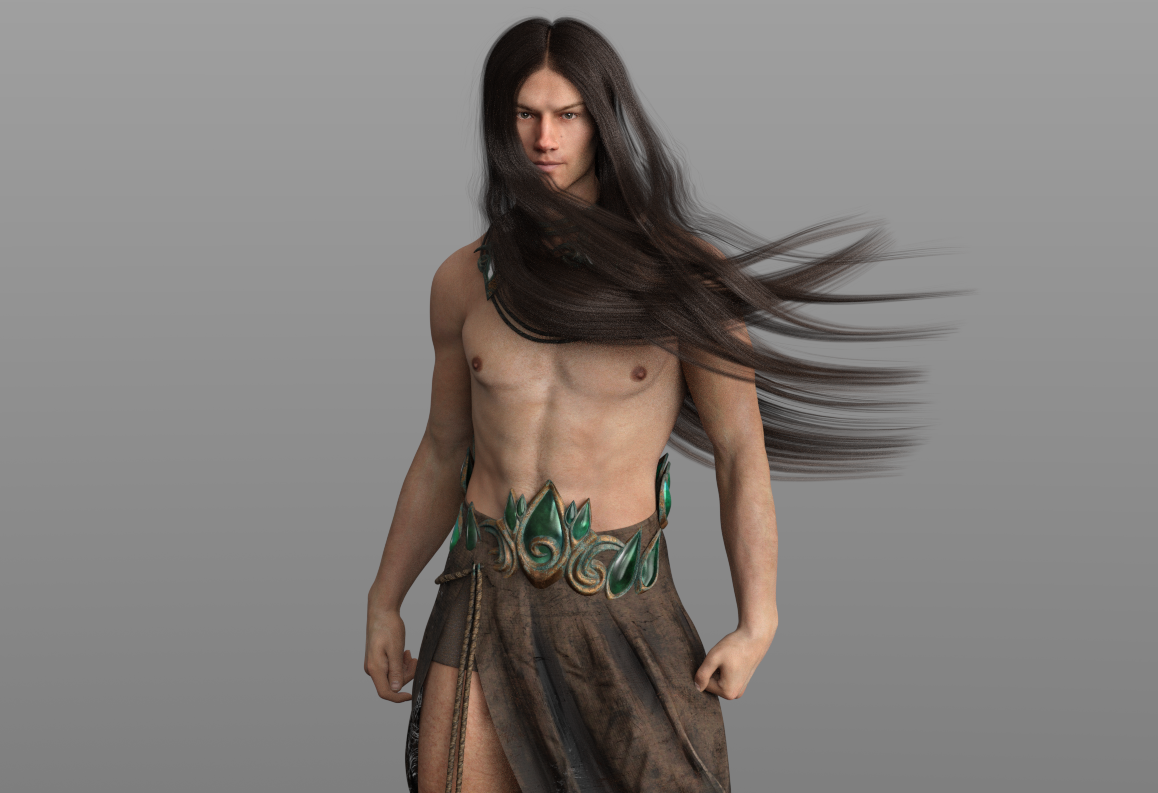

    Keep in mind, Super Sleeky (and many other hairs) work just fine on G8 figures (retain their morphs, etc.) as long as you load the hair without a figure selected and then edit the hair's Scene identification to Genesis 8 Male (or Female) before fitting it to the character. Here it is on Genesis 8 Male (quick render...excuse the pixelation) with the morphs fully functional:
    1158 x 793 - 567K

    Quixotry said:
    Nice! This is very very close to what I was looking for.
