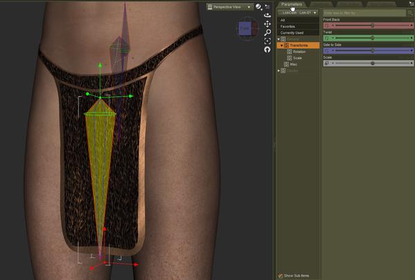

Hi,
I was under the impression that one could copy rigging from one area of the figure and apply it to another area. I have created a quicky loin cloth for Genesis 02 Male and have the front rigged and weight mapped but wanted to just copy that to the back panel rather than having to repeat all that over again.
Can I do that?
If so a tutorial would be great.
Running the newest version of DAZ Studio.
Thanks
Richard
1316 x 889 - 201K

    It's actually possible to copy and paste weight mapping so not concerned about that. There is a mirror option for the bones but it's not doing anything when I try various options with it.
    665 x 622 - 49K
