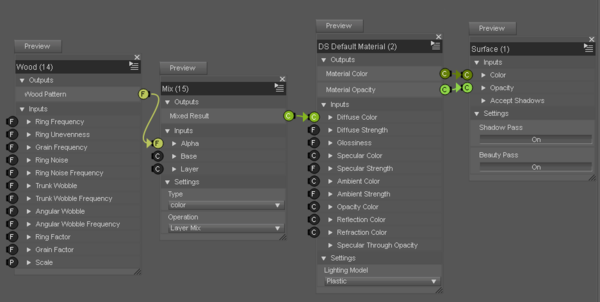

How do I rotate the pattern generated by a Wood brick? I'm not even sure what brick(s) I would use to accomplish this.

    Well, the short answer is that you use the bricks option menu to Show Advanced, which gives you an extra Point input that controls the pattern. However, after some fiddling I'm not sure how the values are turned into wood patterns so a considerable amount of experimentation will be required unless someone else happens along to fill in the blanks.

    TBH I'm not sure if this can be rotated, it's 100% procedural which means it completely ignores the UV of the mesh, and it looks like the pattern is set to run along the length of the Z axis based on the mesh origin.
