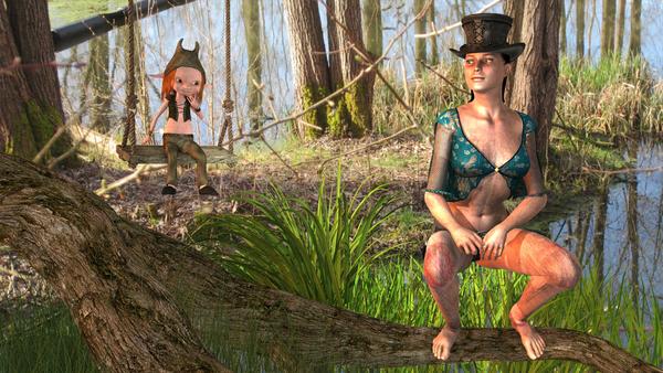

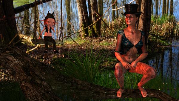

  • RuphussRuphuss Posts: 2,631
    never touched this before
    now 2 examples on and off
    off is a lot darker but more colourfull

  • SzarkSzark Posts: 10,634
    if you really want to understand Gamma Correction then start here http://www.daz3d.com/forums/discussion/18364/P120/#559539 and read the next 3 or 4 pages.
    ruphuss yes it will be lighter if you didn't adjust the lights. ;)
    I just wanted to show the difference between on and off with the same lighting
    and yes I will read that thread
    I hope it enlightens me
    playing around with gamma-on I have to learn everything new because of the totally different reaction
    of the surfaces
    I appreciate that ruphuss and it illustrates it nicely and yes surface react differently when Gamma correction is ON which is the whole point of it and it works better with physically correct lighting that have the inverse square law of light, like dz lights not the ones in the Create menu but the ones in Light Presets, thought the dzpoint lights have an issue with soft shadows not being soft. Uber and AoA's new lights are also good for this too.
