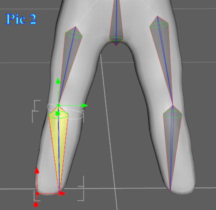

However, I now have another problem with the tutorial.
On page (either 26 or 30 depending on if it's a number actually printed on the page (26) or the page number that's in the thumbnails list on the left - then it's 30)
The instructions say to:
"Now, on the shin bone, move the end point so that it is centered at the bottom of the shin, and align that bone as well."
Well I selected the shin bone, but when I tried to move the end point at the bottom of the shin, (where the foot would be if the figure had a foot) a red axis thingie moved but the bone did not.
See Pics 1 & 2.
I tried moving the top of the shin bone, it did move but that's clearly not the bottom - I'm so confused...
How can I move the bottom of the shin bone? Help?
