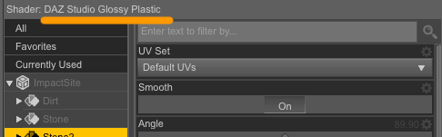

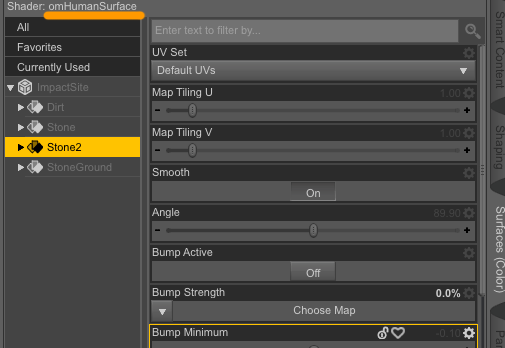

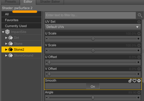

    In the upper right hand corner of the Surface list you will see the name of the active shader, the first one is a stock Daz Studio plastic and I could use it publicly fro any surface I wished. The other two are proprietary and while I could save them to a material file or duf or whatever I could not legally distribute them to anyone since they required additional software to allow those settings in the list to work.
