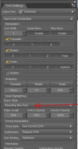

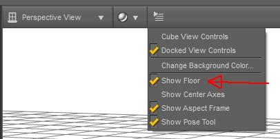

how do i hide the Ds ground plane? stop the orange flashing? can't see what i'm doing in the scifi

i'm working with the scifi lab and i can't see what i'm doing, the ground plane is in the way.
and the orange flashing is hiding things too.

    Viewport context menu > uncheck Show Floor
    With a manipulation tool selected (i.e. not Node Selection), Window > Panes > Tool Settings > set Node Highlighting Draw Style to Bounding Box Only
