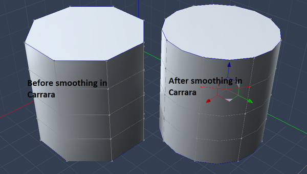

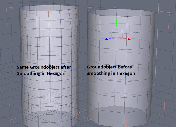

Firstly, how does the smoothing in Carrara work? I have tried a little, and I previously thought smoothing generates additional polygons.
In Hexagon I can see these polygons and also work with it (move, select, ...). In Carrara, I see only my mesh is changing, but I have no possibility to select the generated polygons or points to move them. I have two screenshots added in order to clarify it.

    Same thing. It multiplies each polygon into four for each level of SubD smoothing. So it virtually Subdivides the mesh, and then applies a smoothing algorithm on the higher virtual fidelity.
    See the blue lines on the edges of your Carrara example?
    That (in this case) means that those edges are set to be creased. That is why the end caps aren't collapsing like they are in your Hex example.
    In Carrara, just below smoothing sliders, click Apply to make the virtual subdivision Actual, which turns smoothing off. Turn it back on for further SubD.
    Hmmm... I wonder if Hex's smoothing is virtual or actual. Sure looks like an actual subdivision from here
    True. You cannot select them directly. Only see the results as you make changes to the actual mesh.

    If you want the the extra polygons so that you can manipulate them individually, try the subdivide or tesselate choices under model tab of the vertex modeling room. Make sure your whole object (or whatever you want subdivided) is selected.
