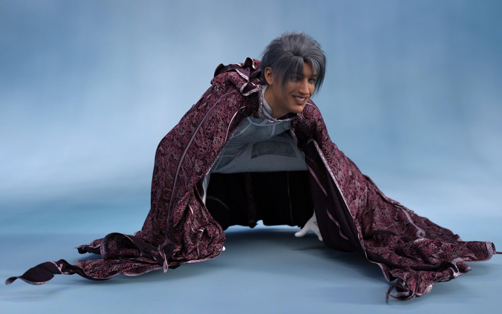

  • ArtiniArtini Posts: 10,923
    edited July 2021
    Finally got it simulated on Owen 8 - https://www.daz3d.com/owen-8
    by using provided pose with arms down and dForce Animated simulation with Better Collision Mode.
    The cloak is very sensitive to settings and explodes very easily during dForce simulation.

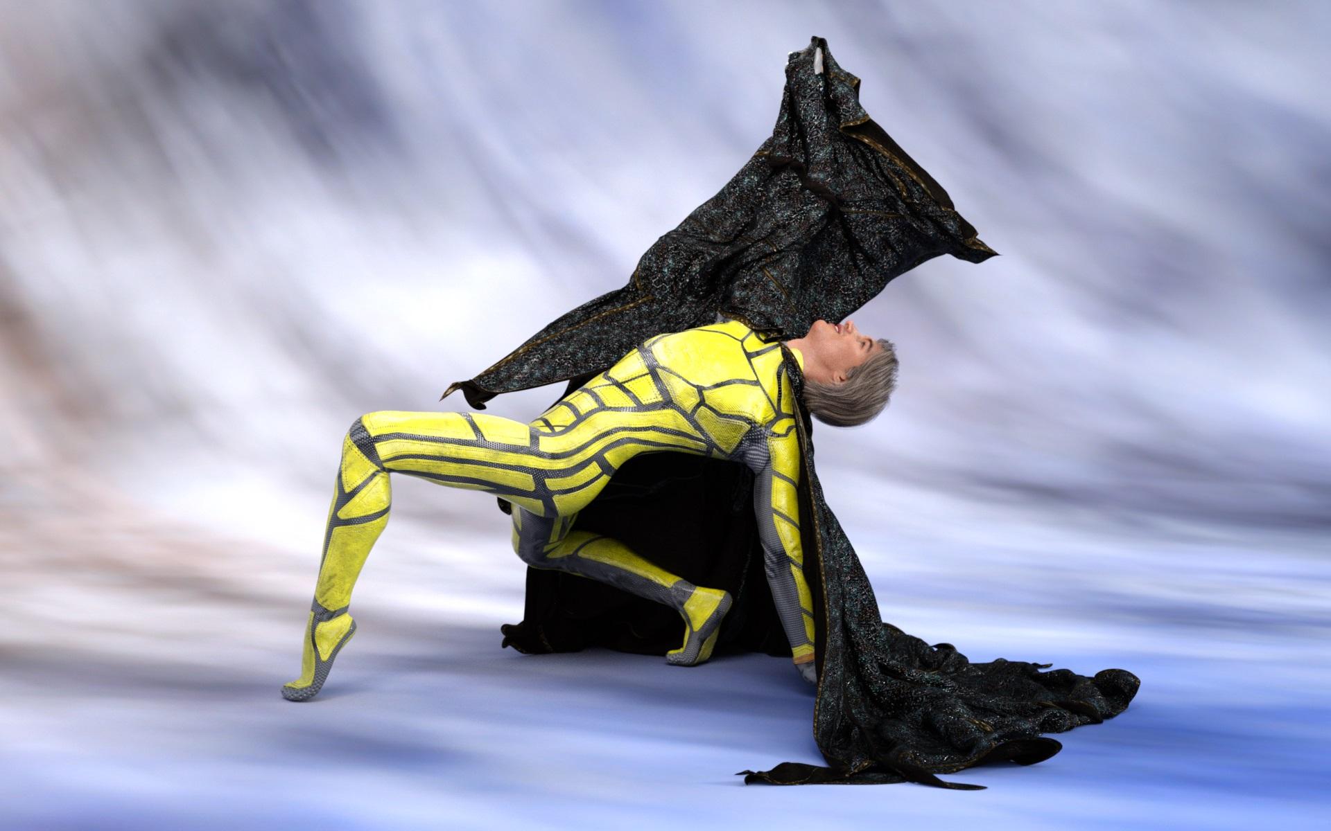

    edited July 2021
    I give up. Each pose needs a different dForce settings and the one below only simulated to frame 24 and then the cloak exploded.
