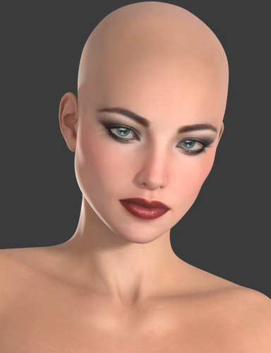

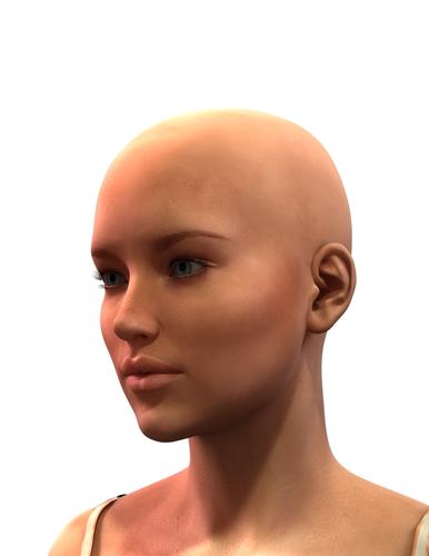

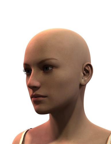

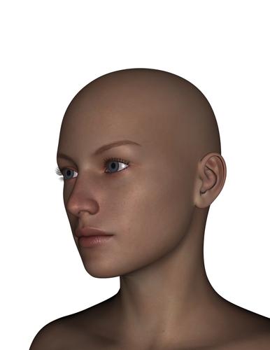

    These ones use Lantios Lights 2, Preset #8.
    618 x 800 - 134K
    618 x 800 - 134K
    618 x 800 - 141K

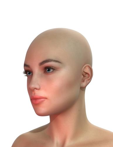

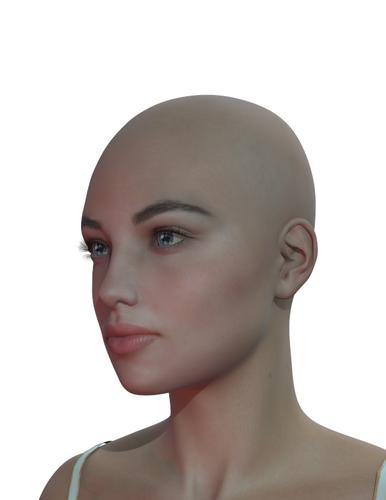

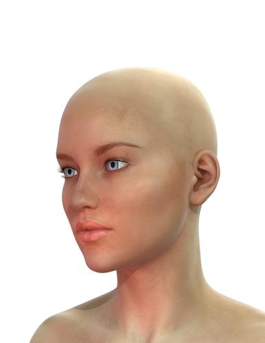

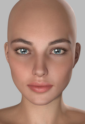

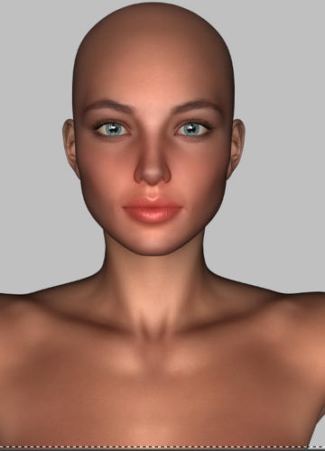

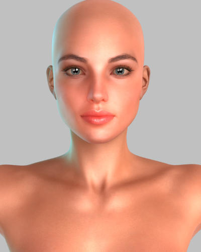

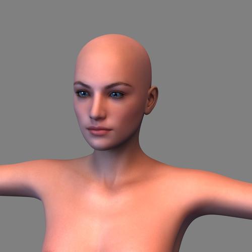

    This one is the "DTAL-ThreePointB" preset from this set: http://www.daz3d.com/advanced-light-presets-for-aoa-s-lights
    Obviously, with default settings, there are some issues with the eyes, but the skin itself I think looks pretty good under this lighting.
    618 x 800 - 144K
    618 x 800 - 143K
    618 x 800 - 141K

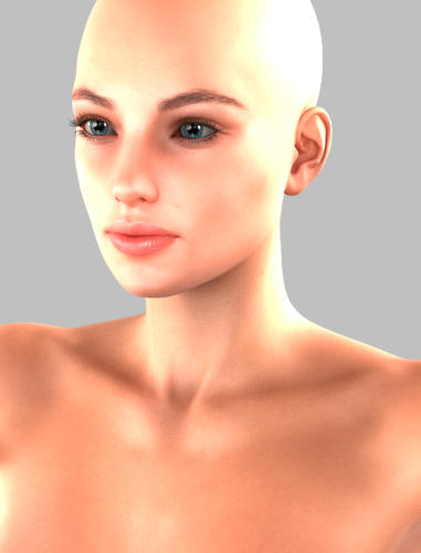

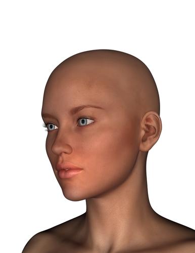

    Last one for tonight...here's Domina with the Domina Lights 2 preset, with the following changes made:
    - Changed Gamma to 2.20 and turned gamma correction on*
    - Changed Group ID for Inner Mouth, Gums, and Tongue
    - Turned on raytraced shadows on the point light
    - Changed Domina's Shading Rate to 1.00 (8.00 by default)
    - Changed Domina's Shading Scale for Group 61 (skin, inner mouth, etc.) to 0.1 (0.5 by default)
    0.1 is physically correct for Shading Scale, but perhaps lower than you might want to go, aesthetically speaking
    (Diffuse strength and subsurface strength were not changed for any surface...and probably should be, as belovedalia found)
    All these renders use an overall render shading rate of 0.1
    *I still use gamma 1.0, GC off as my default, but I'm starting to experiment more with changing this.
    With so many changes at once, this isn't really good science--hard to say how much impact each one of the changes had--but I'm signing off for the night so I wanted to show the results of changing a few things from default values as others suggested.
    618 x 800 - 118K

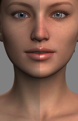

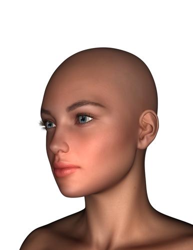

    OK, I need to go to bed, but I wanted to run one more test first...

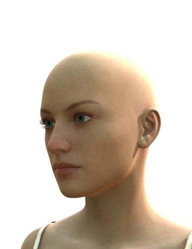

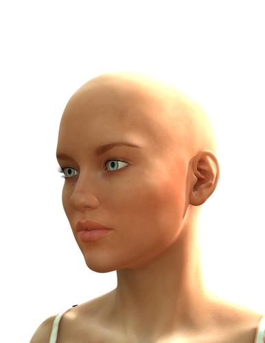

    Q: Do specular lights also need to be set to Raytraced shadows?
    The lighting consists of a single distant light set to specular only.
    1. Shadows off
    2. Raytraced shadows
    So it does make a difference...that's good to know. I haven't always been careful about this.
    618 x 800 - 59K
    618 x 800 - 65K
