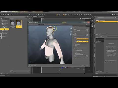

I have decided to try out some of the dForce hair on my figures today.  I have the dForce hair for Darcy 8.
However, selecting it and putting it into a render seems to yeild a bald head.   I also select the dforce hair and tried to put it in a simulation and that also yeilds...a bald head.  I followed this tutorial here:
And guess what?  The end result is...(everyone say at the same time now) a bald head!
So it does seem that the video is leaving something out that I have to do first.
Any assistance would be appreciated.
Thank you,
Geo
