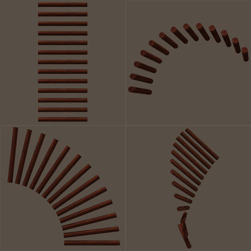

    This looks like a good place to request that someone apply easy pose to the problem. I'm thinking that 2 separate models, the rail and the ties. If I could model, I'd do it myself. In fact, this seems like an easy project for a beginner. I understand that DS has a way to do this with a properly rigged structure.
    Bear in mind that trains make long sweeping curves, not sharp turns. And gentle gradients.
    As an alternative, I came up with a way to use stitch witch to lay out a 2D railroad texture
    LATER
    Quick and dirty. Easy Pose Tube (by Ajax) with a wooden bar parented to every 4th node
    600 x 600 - 101K

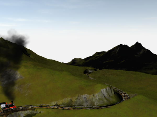

    i just happen to be experimenting with this very same concept - in another thread, been getting some advice on using RaodMaker to carve out roads in a terrain.
    At this point, it is very rough - was testing out a concept to see whether it was worth pursuing.
    I used Hexagon because that is my comfort zone and Carrara doesn't have some of the tools I needed, but I'm sure if I give a brief description, someone will explain how to do this in Carrara :)
    Once you've made the roadbed - either using RoadMaker or a 2D paint app to modify the terrain heightmap, make a copy of the terrain and convert to mesh.
    I imported as .obj into Hex, extracted a curve along the length of the cutting, duplicated and and offset it. Gave the two offset lines thickness - for close-ups I would make a proper shape of the track and sweep it. Made a sleeper from an elongated cube and copied it on a support using the duplicated curve.
    Deleted the terrain and imported the railway track.
    It is really rough, but it showed it was worth taking the trouble to do it correctly :)
    640 x 480 - 57K
    640 x 480 - 40K

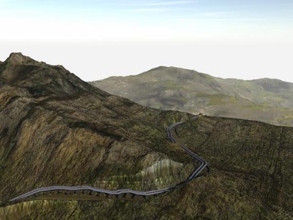

  • RoygeeRoygee Posts: 2,247
    Finally got my method to work:)
    The challenge was to get a smooth curve off the surface of the terrain - couldn't do that after converting the terrain to .obj, so made the terrain in Bryce, which interprets heightmaps more accurately than C. Exported as .obj and used a feature in the VM which is superior to Hexagon - the ability to draw a curve along a surface.
    To get the curve into Hex, I swept a circle path and extracted the curve from that in Hex. Everything followed from that.
    So glad to get it sorted that I ended up making an anim - haven't done that in ages, but with my new 64bit machine zipping along with four cores, it is once again a lot of fun!
    The video is at http://youtu.be/k7GlIoJMZ1Q
    640 x 480 - 223K

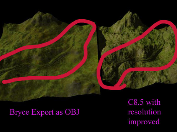

    Yes, resolution is what it is all about - in Bryce, when you export an object there is a slider that lets you select the poly count to some insane numbers. Mine is 54K.
    I found that in C, at 2056, the cutting was a shallow valley with lumpiness on the floor. The Bryce import had well-defined cuttings and an absolutely flat road surface.
    Yes, this is very do-able using only Carrara - just for me using all three was more convenient.
    Did you find that .tif gave better results than other formats?

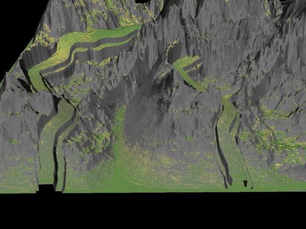

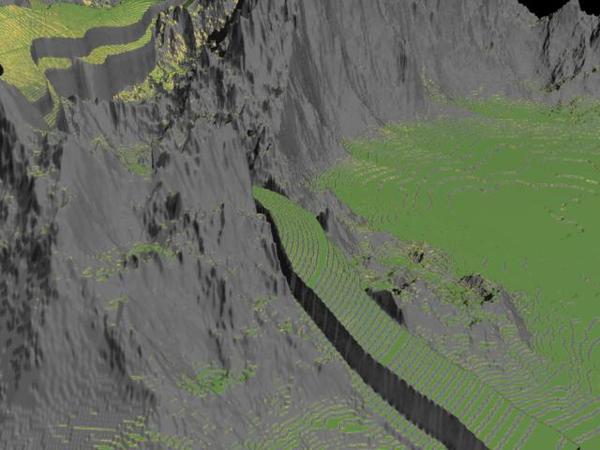

  • DiomedeDiomede Posts: 15,469
    edited March 2014

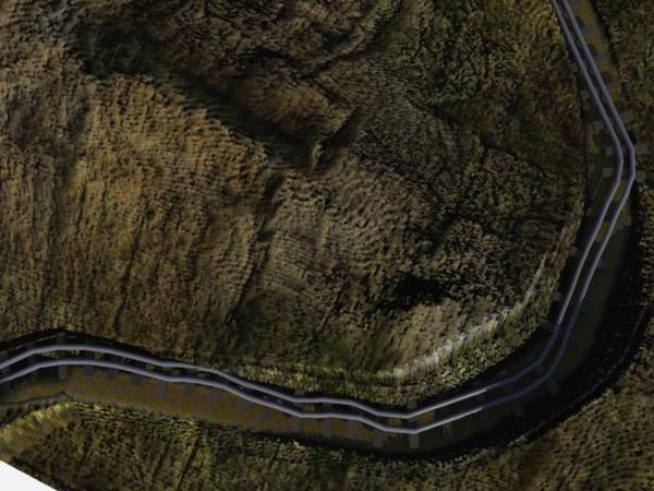

    I did a couple more tests, and they confirm your point. I used a .tif file exported from PS. There seems to be a tradeoff in C8.5. At a higher resolution, I can get defined cuttings and raised roadbeds, but the path will not be smooth. The path is terraced, as is the terrain mesh more generally. On the other hand, at a lower resolution, I get a smoother path, but the terrain loses a lot of its detail. I wonder if that could be partially addressed in the bump channel. I tried keeping the higher resolution, but using a smooth filter in the terrain editor, but the results were not all that different from just using lower resolution settings in the terrain editor.
    You should be able to see the tradeoff of a terraced path vs less detailed terrain in the attached pics. (Edit - note, the pics just use the default terrain shader and the default lighting)
    640 x 480 - 33K
    640 x 480 - 42K
    Post edited by Diomede on
    I seem to recall that there was a way around that, but it ecapes me. When I remember or figure it out, I'll post it.
    Within C8.5, I can't tell the difference between tif and jpeg. In the attached, I have two terrains side by side (overlapping). The path on the left is from importing the heightmap in tif format. The path on the right is from importing the heightmep in jpeg format. Otherwise, the terrain settings and shaders are the same. The path on the right is partially obscured by the left terrain. My eye can't tell the difference between the terrains or paths, but whatever is causing C8.5 to be less accurate than Bryce might also be preventing Carrara to take advantage of the extra detail available in the tif format.
    @EP - if you can remember a solution, that would be great.
    I think I am following the same basic methods that Mark Bremmer and PhilW use in their tutorials, at least for the Photoshop portion, but I will have to go back and rewatch them. I can only think of 2 differences. First, I smooth a path within a path so that I have a wider roadbed (shoulders) and a narrower road. Second, I use the "enhance" / "hue" function in Photoshop to raise or lower the roadbed above the shoulder. But I've gotten similar results when I don't use the hue enhancement, so I don't think that is it.
    640 x 480 - 44K

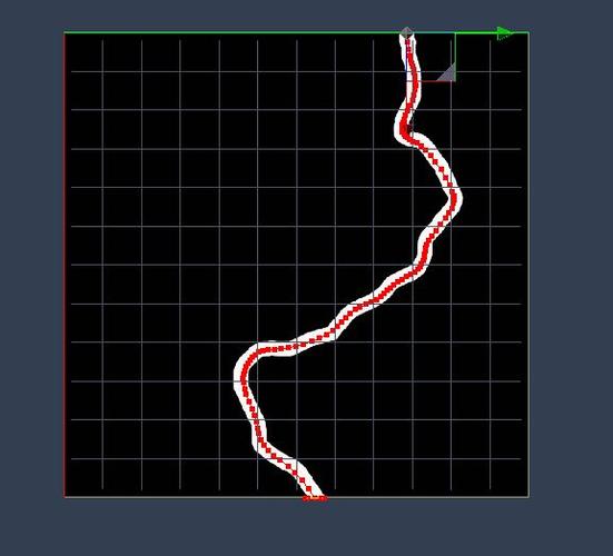

    I spent most of the day trying to rehook various devices to the internet after my service provider decided to change my wifi name and password. But, I did set aside a few minutes to try to extend RR tracks along the road bed.

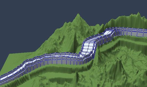

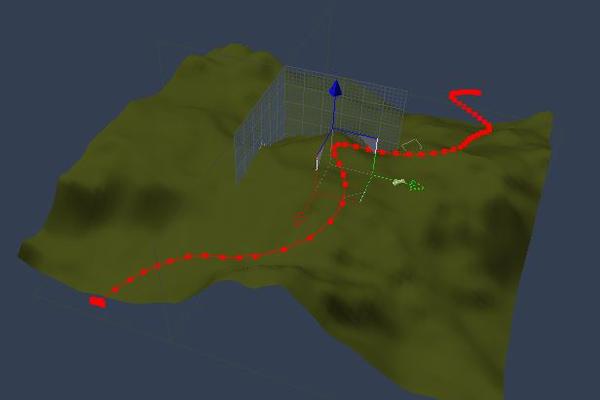

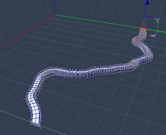

    First, In the vertex modeler, I used a simple grid to make a cutaway of a RR track (box with two small boxes rising above). Then I went into the vertex modeler, using the top camera, and brought in the road path that I used in Photoshop to carve out the roadbed (black and white image) onto the background of the drawing plane.

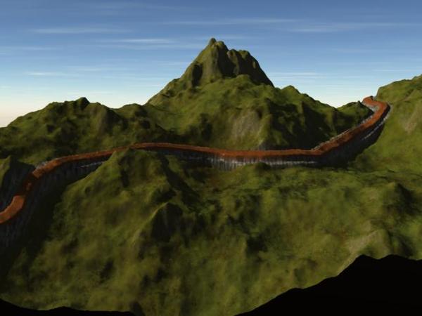

    With the RR cutaway at one edge of the path, I used the curve polyline tool to follow the path. I then used the sweep function to extend the RR cutaway along the path.
    I then went into the assembly room, and used the model in the assembly room feature, to resize and raise the RR to the roadbed.
    I'm not going to try to make it look nice, but I had said I would try it this weekend and I'm running out of time.
    650 x 385 - 46K
    564 x 458 - 40K
    577 x 524 - 39K

    Great wall of China? Yes, well done. I was actually experimenting with ways to make a wall through a terrain when this railroad thread was started. I was considering doing a wall (maybe the Roman walls in Scotland) for the fence challenge, but changed my mind. Someone could use this same method to make a RR track, or a wall, or a fence, or anything else that stretches across an undulating terrain or to span bridges. The more practiced a person is with the polyline tool, the easier and better this would be. Unfortunately, I've only just started experimenting with the polyline tool, but I can see a lot of potential.
