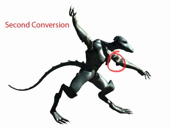

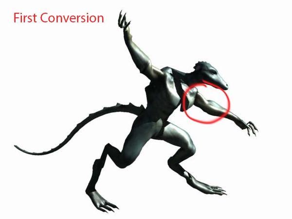

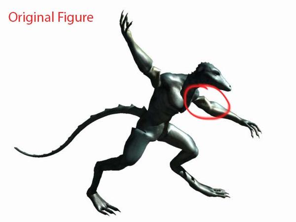

    Now I'm really puzzled. This gave a different CR2 output, but the final CAR was identical to that produced by the first version? I did it twice to make sure I was selecting the correct files.
    In any case I'd meant to post examples of the differences so here goes. I've labeled them in-picture to avoid ambiguity and circled one of the examples of difference in each, though it isn't the only one. I didn't bother with a third conversion image as the final CAR file is identical with the first conversion.
    640 x 480 - 37K
    640 x 480 - 37K
    640 x 480 - 36K
  • FenricFenric Posts: 351
    That looks like it might be capsule-zone (Poser 8) rigging, not weight-mapping at all. Carrara doesn't understand anything newer than Poser 4, and a lot has been added since then.
    Carrara is always weight-mapped: that's all it understands. So, when Carrara imports the CR2, it converts the angle/sphere-zone joints to a weight-map. My weightmap importer just replaces the one Carrara calculates with the one from Poser.
    But there are a number of common issues with the Poser files that will confuse Carrara's CR2 importer and result in a garbage weightmap. Once that happens, there's no recovery - that's why I made the "PrepPoserFile" command. Some things are just too weird to fix automatically - like the Smith Micro feet parenting issue. Really, you should just fix that in your Runtime and leave it fixed for everything. This worked well for the old hybrid figures like V4-WM, Miki 4, Ryan, and Alyson/GNDA, but just isn't working for the newer ones.

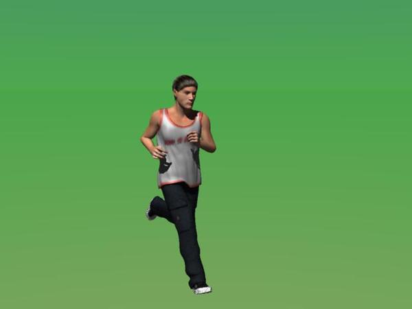

    There is always the option of creating the figure/pose the way you want in Poser and exporting as an .obj file. Here is the weighmapped version of Ryan, clothed and posed in Poser, and exported for use in Carrara as an .obj.
