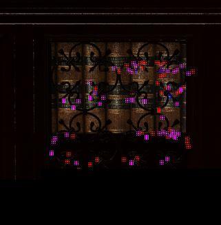

I'm getting a lot of little red and pink glitches during my renders, and I was wondering if someone knows exactly what the cause is, and if there is a fix. I'm attaching a small snip so you can see what I'm referring to.

    That happens when you have lights with deep shadow maps and raytraced shadows in the same scene. Or maybe it is just the deep shadow maps. I know if you put the lights to ray-traced it goes away. Hang on, let me find the other thread.
    Edit: found a couple of the threads talking about this. Hope the info helps.
    http://www.daz3d.com/forums/discussion/34991/
    http://www.daz3d.com/forums/discussion/18450/
    http://www.daz3d.com/forums/discussion/2477/

    Oh, nice! Thank you, that's a much easier solution than replacing my laptop. I really appreciate the links.

    Deep Shadow Maps in the 3Delight Render engine has a error. The Makers know of the error but have not been able to fix it. Until further notice they suggest that users only use Ray Traced shadows. Even one light set to DSM can cause the error.
