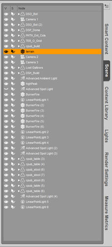

  • Richard HaseltineRichard Haseltine Posts: 112,060
    IN DS4 the geometry belongs to the root node - what exactly do you have selected when trying to apply the DForm?

  • reserv888reserv888 Posts: 1,164
    @Richard
    I am using Versatile Terrain 2 and I am just clicking on the ground (see pic)
