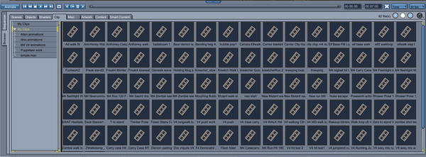

    It's perhaps obvious but I think worth mentioning. Saving clips in your browser.
    once you've made a master clip, drag it into your clips section of the browser.
    It also helps to create some new folders in your (user/My Documents/Daz3d/Carrara/my presets/ my clips, just to organise things.
    It's really easy to be working in a scene, making clips or other stuff, and completely forget to save the bit's into the browser so you can use them in other scenes. or maybe it's just me that forgets. :)
    1380 x 509 - 233K

  • msolomonmsolomon Posts: 213
    I totally agree. When I get lost in a job chaos will ensue. The multiple folder idea is a good one.
