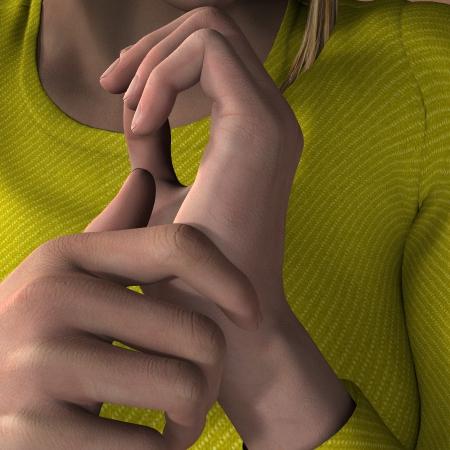

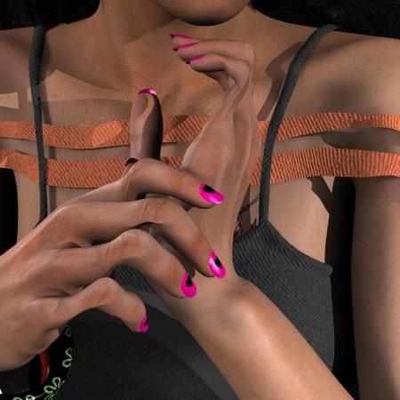

I'm not sure if someone let all the air out of my character, slammed her hands in a window frame, or what, but suddenly this character doesn't seem to be smoothing, or whatever it is that Genesis 2 figures do by default when posing.
Here is an example of whats wrong.
First Image Below

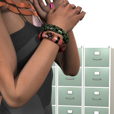

the same pose is applied to another figure in the same scene and it's working properly,
Third image below
Just to claify, It's not just the hand on the malfunctioning figure, but all joints, and likely the entire figure.
Middle image below
Can anyone tell me what's going on here, and how to fix it? I've gone so far as rebooting my computer in case the smoother was hung again. I'm trying to learn the issue rather than just work around it. Hopefully it's something simple.
Thanks!

    V4 pose on Genesis?
  • WolfschadoweWolfschadowe Posts: 18
    mjc1016 said:
    V4 pose on Genesis?
    Nope. Both figures have the same pose. It's a V6 pose on Genesis 2. Zero pose and manually dialing in the figure does the same thing.
    Wolfschadowe
    More information needed.
    What pose is it, and where did you get it from?
    Can you load a new G2F figure, and apply this pose correctly.
    What are the two figures you are comparing, are they both G2F, and are they both freshly loaded, or loaded from a saved scene?
    On the one that is wonky, can you select the figure, then go to the Parameters pane, and click on 'Currently Used' to see if any other morphs are being loaded as well?

    In the images I posted, One is a base V6 where I played with shaping dials (the one that works) and the other is FW Sian, also from the DAZ store, and I played with shaping dials on that one as well to tweak.
    My results. The pose is Standing 1, from DM Sensual, from the DAZ store. It works fine in a new, empty scene on base V6.
    I loaded another V6 figure and applied the FW Sian shape, and the problem came back.
    Some playing around, I've determined it's definitely the FW Sian shape slider that causes that corruption to the figure. I have several other FW figures, (FW Diana, FW Danika, etc...) and they all work fine. I can dial them in and out of the same figure with no problems. but the FW Sian goes all flatworm fingers. I deleted and reinstalled the FW Sian files but that didn't help.
    I suspect I stumbled on a bug, maybe. I'm too much a newbie at this to know for sure. What are my next steps? Is there a protocol for letting the vendor know there may be an issue?
    Thanks for the help and advice!
    Wolfschadowe
  • Richard HaseltineRichard Haseltine Posts: 112,059
    Sian seems to be working for me. It looks as if the links that adjust the joint centres are broken, though since Sian uses the G2F body morphs that should affect all characters. What were the exact steps you went through to get the broken figure?
