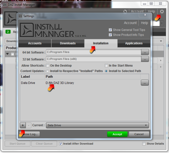

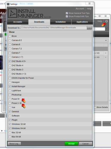

  • JaderailJaderail Posts: 0
    Set the DIM to use the POSER version you have... in the GEAR.
    Set the PATH in this Part using the Browse and ADD and Minus button...
    I think this is where I'm getting screwed up. I try to add a shortcut to the list at C?ProgramFiles(86)/SmithMicro/Poser9. It tells me that "The folder specified contains files that were not installed by InstallManager. It is strongly recommended that an empty folder, or a folder previously managed by InstallManager, be selected." Duh? Do I tell it to install there, anyway? Or do I make a new folder? I'm still lost. lol
