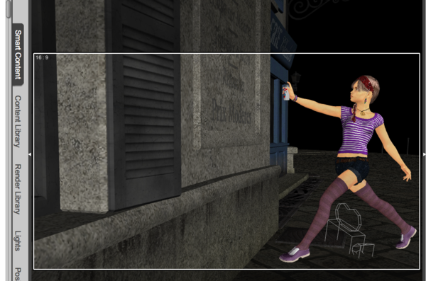

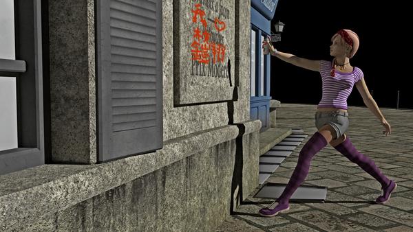

Leo ChenLeo Chen Posts: 697
I use Luxus to bridge to LuxRender.
The image come out has something wrong!
1. The Skin Tone is very granny.
2. Some texture's color is very wrong.
1920 x 1080 - 717K
947 x 627 - 803K
  • SimonJMSimonJM Posts: 6,108
    It might just need a 'bit more' time to de-speckle and clean up the image. How glossy are the surfaces in front of the figure? What sort (type and numbers) of lighting are you using?
    Also, if the textures were 'autoconverted' they may not actually set up optimally.

  • Leo ChenLeo Chen Posts: 697
    I use only default setting...
    The blue color of the pant just be totally gone, how come?
