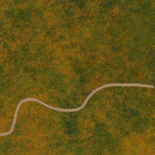

I have a baffling problem. The first pic is a procedural texture of a terrain exported from Carrara, with a road texture exported from RoadMaker layered over it. The layer is merged down and is in .jpg format, so no floating layer.
The second pic is how it maps using the import function in 3D paint onto the terrain it was exported from - the original texture was deleted from the terrain before importing - see how the road texture is totally out of place?
Any explanation as to why this should happen? I've done this before, many times, and the texture always came in correctly in place.
Secondly, how do I layer a texture over another using the import function in 3D paint? I can make a new layer, but can't find an option to bring in another texture to layer over the backgrounf texture.
1024 x 1024 - 513K
1024 x 768 - 202K

    The second image looks rotated 180. In that state, the bulk of the green grass does appear to be on the correct side, but when rotated back, will it still be so? Just food for thought. I've never used the app you speak of. But I've never had an issue getting height and color maps lining up correctly either.

    This was just Carrara doing its occasional trick of bringing in texture pics flipped and rotated. Eventually got them aligned in the texture room by using parametric projection and fiddling about with rotating and translating.

    In this particular instance, I had a problem in that there is no option in Roadmaker to choose output resolution, it does it at 1024 X 768 and the texture it had to overlay was at 1024 X 1024, so Gimp centers it. Not having any reference point on the underlying texture, it is a hit-and-miss exercise to get it correctly placed.
    So, I had the idea that if I could do this in 3D paint, where I could see the contours, this would work.
    I did first try bringing it in in the texture room, but this was far from satisfactory. What I did was to use a mixer, with the background texture as source 1, the road as source 2 and the the alpha map of the road as the mixer. It was a mess, with the road surrounded by a jagged white line. Using pre-multiplied alpha made it slightly better as the jagged white line became semi-transparent.

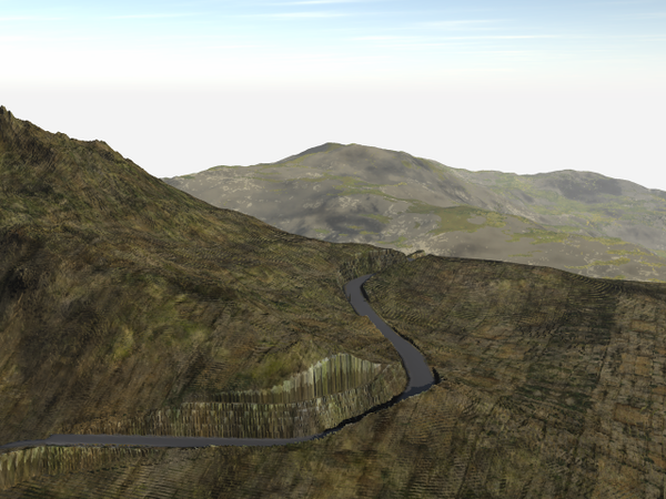

    What I've settled on is to duplicate the terrain, leaving it in place. Deleted the shader from the duplicate and textured the duplicate with the road, using a mask in the alpha channel.
    This way I can continue tweaking the shaders without messing it all up:)
    In this one, I've replaced the colours in the shader with good pics of rock and grass - not working very well at the moment, but I'll keep at it.
