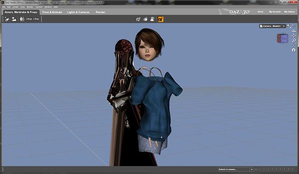

Hi. Has anyone else experienced models (e.g., Genesis and Genesis 2 Female) breaking apart upon reposing in DAZ Studio? I've had this happen several times and haven't found a way to stop it. I even reinstalled DAZ Studio 4.6, but it didn't do any good. Renders are fine, but it's almost impossible to pose the models the way I want because of the visual chaos before rendering.
By breaking apart, I mean that arms and legs sometimes break off, leaving one part somewhere on the screen and the other part somewhere else on the screen. Sometimes eyeballs pop out and hang in space, as do teeth. Hair sometimes hangs free apart from the model. And very often I get stretched lines that totally obliterate most of the model (see attached screen capture). I've tried stripping everything but the model out of the picture (deleting the props as opposed to just hiding them), and the remaining model still breaks apart.

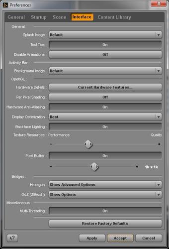

    So it renders OK? What are your options for Skin Binding and SubDivision in the During Manipulation group in Tool Settings? Also what settings do you have in Edit>Preferences>Interface?
  • BitstreamBitstream Posts: 38
    Richard,
    I confess that I don't where those options are set (Skin Binding and SubDivision), nor exactly what they do (I'm fairly new to 3D graphics). As to the Interface settings, please see the attached screen capture.

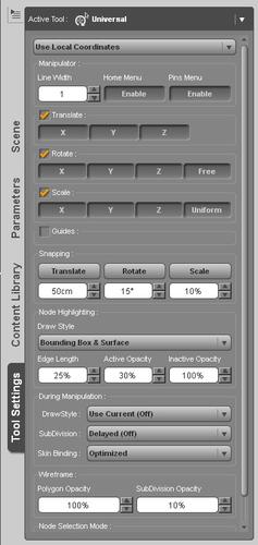

    The other settings are in Tool Settings, with a posing tool active - Window>Panes(Tabs)>Tool Settings.
    Thanks.
    See attached screen capture:
    380 x 802 - 83K
  • Richard HaseltineRichard Haseltine Posts: 111,875
    Try setting Skin Binding to Full.
    Didn't seem to help.
    1075 x 789 - 95K

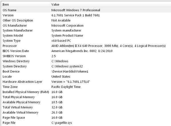

    I looked at the link you sent. It says I need AMD Opteron/Phenom processor(s). **shrugs** I assume that means "at least that," not necessarily "exactly that."...(?) Below is my system information.
    mjc1016 - I think this will answer your question, too.
    As you can see, I've got issues with a couple Mirage Drivers, but I'm not sure what that means. When I tell them to update, it comes back saying that I have the latest drivers.
    Two or three weeks ago I lost all sound on my computer and any reference to having DVD/CD drives on my computer. It's something that I'll be taking care of soon, but, in the interim, I was not having any problems with DAZ Studio until just a couple/three days ago.

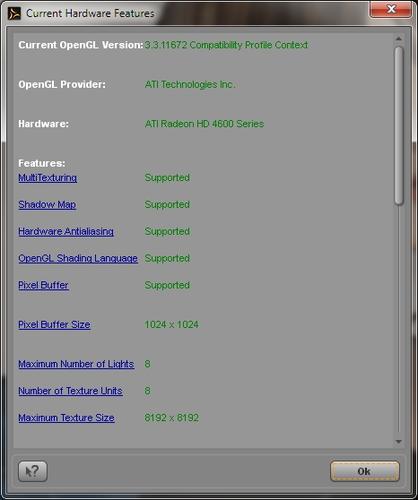

    This is what I see when I bring up Help-Troubleshooting-About Your Video Card:

    Mirage is the manufacturer's version of your video card drivers...and they basically ended back in 2010 (at least for that card). AMD probably has more recent drivers available.
    http://support.amd.com/en-us/download
    (last one for that card was in Oct of 2013)

    Playing around with DS settings under Edit / Preferences / Interface / Display Optimization, I found that "Best" is what is screwing up my models. When I put it on "None" or "Better," the models display fine.
    So, the problem is solved, I guess...but does anyone have a suggestion as to why the "Best" option messes things up?
    Thanks for your input.
  • TotteTotte Posts: 15,229
    Best uses more optimized OpenGL code, but if the videocard or the driver does not support that (or implements it wrong, very common) you will have display errors like that, or even crash or bluescreen.
